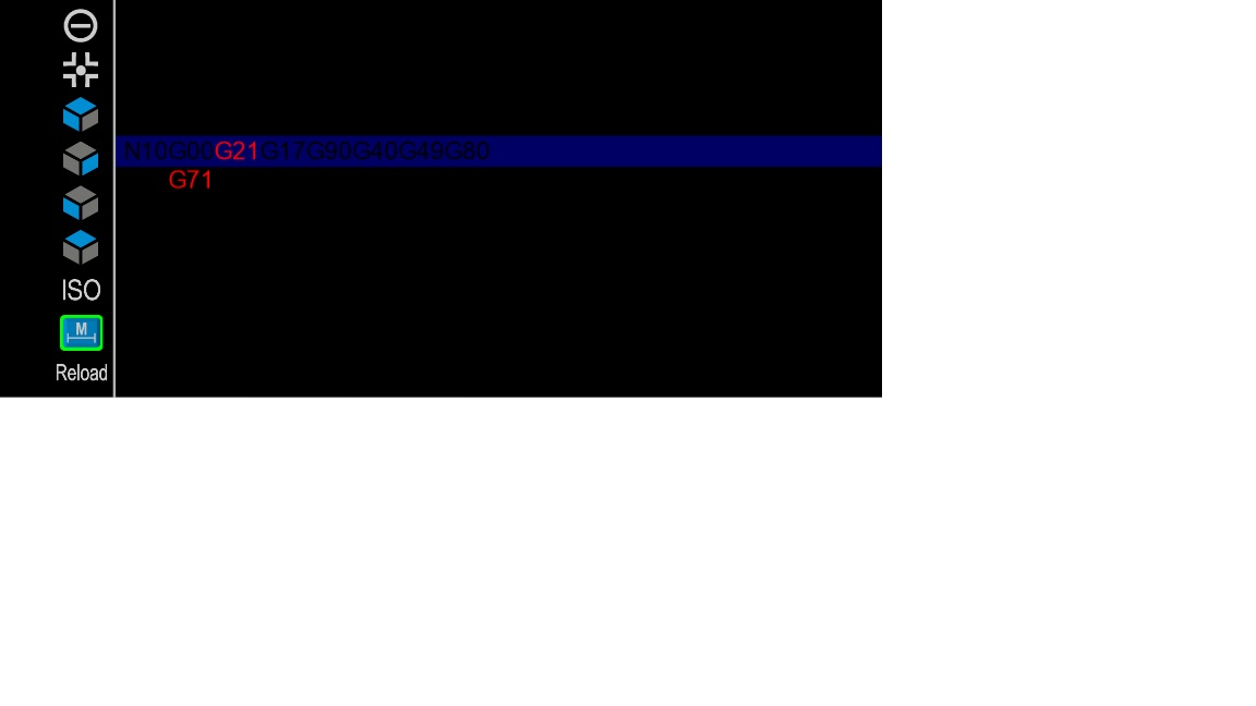

Hi
As soon as I save the settings, the color disappears in the G-Code display. It doesn't matter if I press the save settings button, use a macro, or update the tool length during probing. Version 1.2117.
PRO.jpg shows the difference before and after saving.
Screen.jpg shows the result after saving.
Multicam3000.pro is the damaged profile, and Multicam3000 OK.pro is before saving.
thanx
Andy Goodman

Postby cncdrive » Thu Mar 13, 2025 5:06 pm
I have checked and it saves without problems at me.

Postby Andygoodman » Thu Mar 13, 2025 9:22 pm
ok, Well, we have several other machines without this problem. Can you check this profile to see if it is corrupted?"

Postby cncdrive » Fri Mar 14, 2025 8:11 am
I tried to save it using the profile you uploaded and it saves without any problems.

Postby Andygoodman » Tue Mar 18, 2025 3:47 pm
Ok, I'll try a reinstallation and add the profile again.
