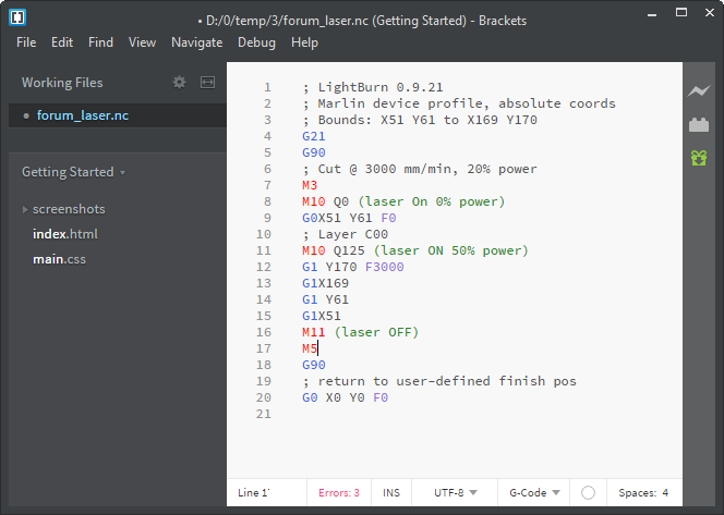

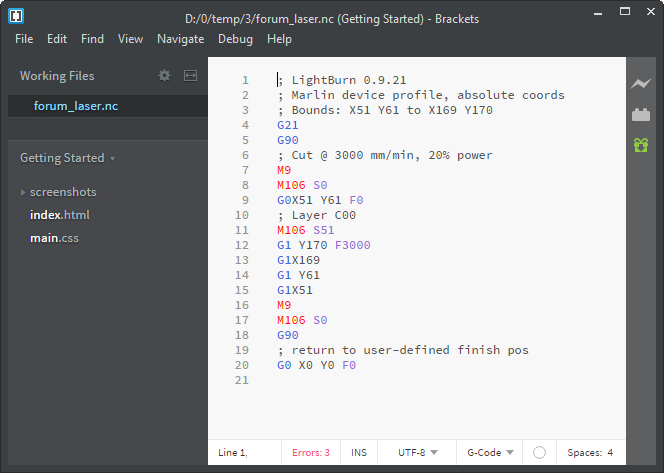

Postby laki » Thu Mar 25, 2021 11:45 pm
You will have to modify the g code
Instead of
insert this

Postby laki » Fri Mar 26, 2021 5:14 pm
Have you found the Marlin device is the best starting point? I had read that it is too slow for some raster images.
This may be the case when using a laser with a 3d printer directly from Lightburn.
I have an ender 3 pro 3d printer and that’s why I use marlin.
When you laser engrave on your cnc machine, it doesn't matter if you use a marlin or a grbl to generate code for UCCNC in Lightburn, you will definitely need to modify the g code to use a cnc machine that works with UCCNC.
If you do not want to modify the g code you can use the laser engrave plugin that comes with the installation of Uccnc.

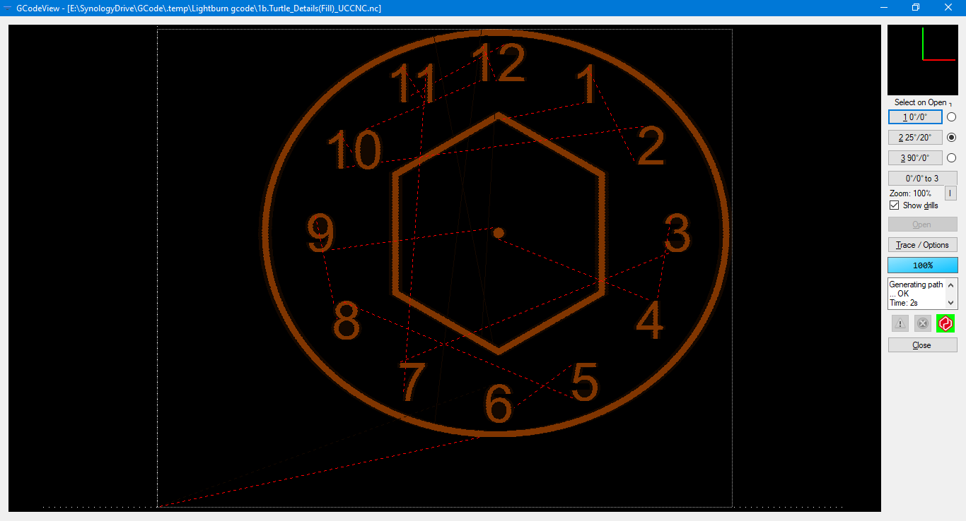

Postby dezsoe » Wed Jul 14, 2021 3:10 pm
I did some experiments, see attached. There is a minimum Q value (20) set so the laser won't fully turn off. Of course, it can be set. You can see the dark overhangs where the laser is powered low. Does it seem to be usable?
