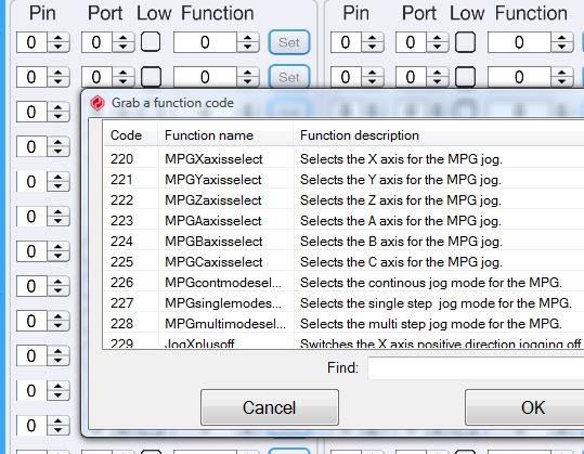

As easy as connecting the axis selector to functions ?

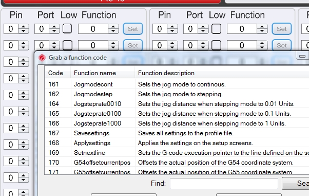

and the step rate increment function respects the mpg input ? (just doesn't say MPG in the description) ?

There are the MPG pins on the I/O setup page. And the buttons etc. you select where you showed on the printscreen.
The increment selection knob is a bit more tricky, because it will not trigger when you start the software, because the knob is not changing the input state.
One way to resolve this issue is to wire a PWM signal through the knob instead of a fixed voltage, e.g. the charge pump PWM is fine for this purpose and then it will update the knob continously, so the selection will update to the actual value on software start.
