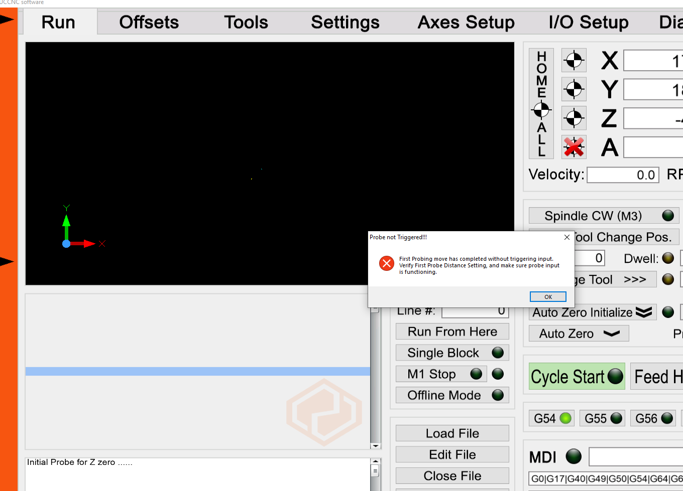

I just installed 1.2114 in a separate folder on C: (C:\UCCNC-12114), then copied my profile (micke.pro) and Ger's Screenset 2017 and macros to the proper directories.
Started up UCCNC with the profile micke.pro, checked that all was OK. Homed all axis, jogged around with my numeric keyboard. Did an Auto initialize. All was good, it probed the mobile probe, then went to the fixed probe and probed. no problems.
I then enabled the UCR201 and restarted UCCNC. Did the same, homed all axis, jogged around with the UCR201, no problems. Did an Auto initialize. Got this error immediately:
Probe error with UCR201 enabled.
I then shut down UCCNC, disabled UCR201, repeated the procedure, Auto initialize was OK.
I then did a complete Windows Update (I am running LTSC of Windows 10, that is 1809 without any bloated MS software). I got some .NET updates and the 2021-10 update and the computer restarted.
I then run UCCNC1.2114 without UCR201, all was good.
Enabled UCR201, tried Auto initialize and Auto zero. None of them worked.
I am running MySensors with RFM69 radios, those use 868 MHz, the same as UCR201 if I am not misstaken, I don't know if that is an issue at all as UCR201 works perfectly with jogging, it is just when you call a macro to do Auto zero or Auto Initialize.
My suspicion is that something is blocking the macro's trigger functions when UCR201 is enable.
