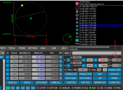

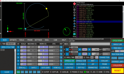

Hello there, here are a few informations i got after some testing. Think i can share that for other users. And i also have one question for support.
Tangential parameters in UCCNC settings :
- For stop angle and retract angle i use 90° and it helps to have a smooth motion with G1 moves. If you use 0 for stop angle, the machine will stop at every G1 move end and it will shake.
- I also use the " roll over on 360 and 0 for both soft limits.
- So far i've been testing different shapes and it works good. No need for A code in the post processor, you can see the green arrow on the UCCNC screen turning as expected.
But ..
Question for support :
When using G1 moves (defaut il fusion 360 UCCNC processor) it seems that the feedrate is 10 times lower than expected (see picture " speed behavior " attached). This code was generated with fusion 360, " TRACE" operation and standard UCCNC post processor. Please see attachement.
I have generated simple circle GCODE with inkscape too, it generated arcs G2 and G3. Same feedrate that in fusion 360, but this time the machine moves full speed as expected. Do you know why there is a difference ?
I believe if this is corrected everything will be perfect to use the tangential knife !
Thank you for your help

Postby cncdrive » Wed Jun 25, 2025 1:18 pm
With very short segments when the tangential knife is enabled and the direction changes it can cause slowdowns especially if the tangential knife acceleration and speed has a hard limit, try to adjust teh tangential knife axis velocity and acceleration higher.
Also you can try to force the Fusion post processor to not make extremely short line segments.
