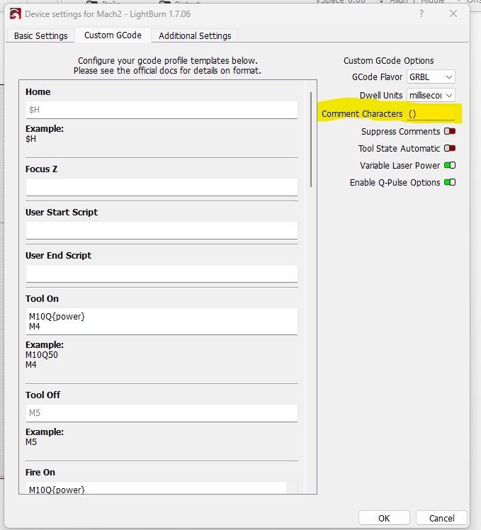

I think I answered one of my questions on the comment characters.
I found where to change that in Lightburn. It was set to use a semicolon. I change it to ().
Now for the M10Q{power} and M4 commands.

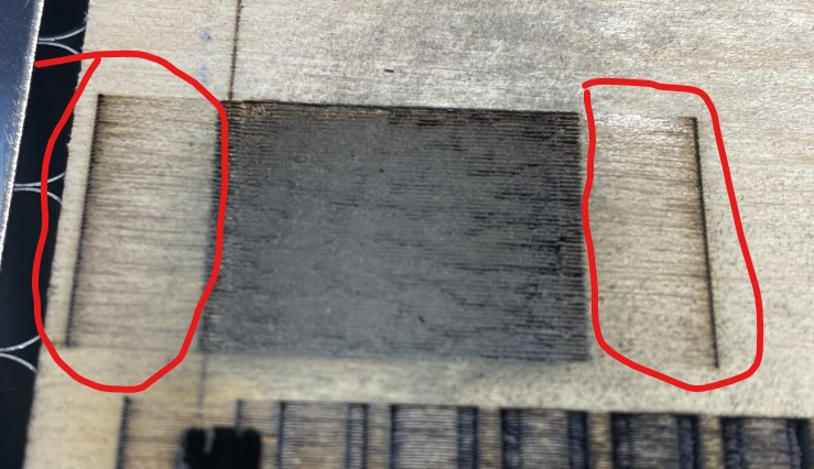

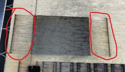

When engraving or more like fill with lower powered cut moves. I am getting these "witness" lines in the overscan area of the moves. I expect the laser to shut off in that part of the move, and it is staying on although at lower power. It can be seen in the results and visibly when the laser is running the tool path.
Results.

Between the M10Q0 or the M11 commands be cutting the power to the laser in the X0.333 and X-0.333 moves? That is the overscan part of the Lightburn generated g code.
Thoughts?
Maybe something not configured just right in UCCNC?
