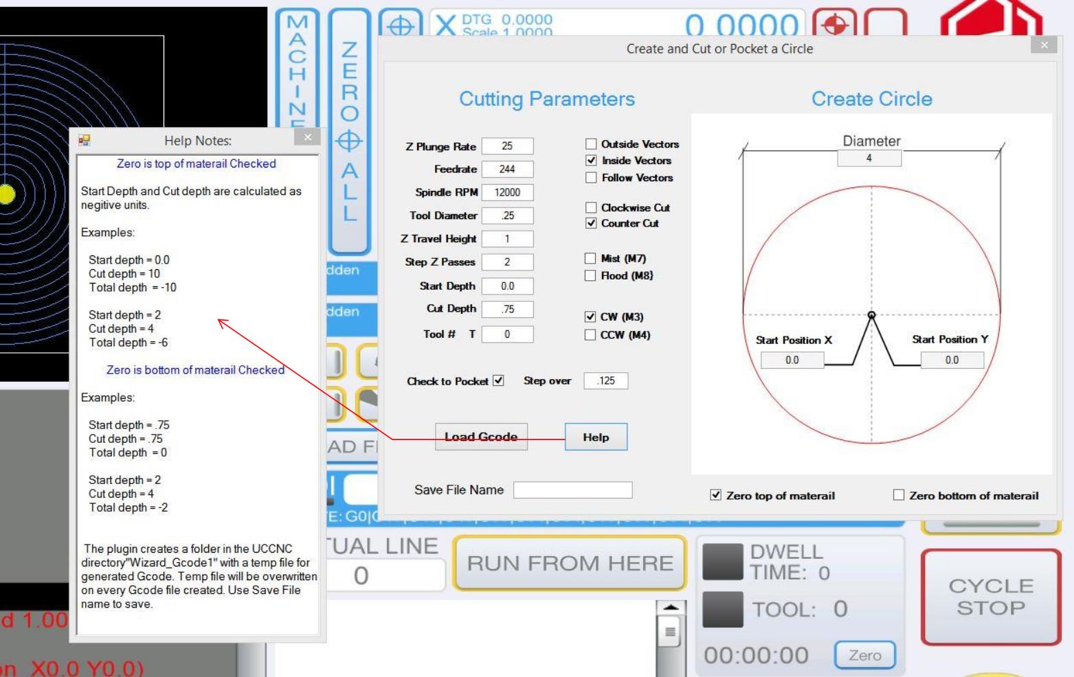

Postby Dan911 » Fri Dec 28, 2018 7:15 pm
I'm rewriting the wizards in wizard plugin and posting as individuals here. I'm eliminating the use of all the G9I(incremental) calls and adding some request such as a Z start and zero top or bottom of material.

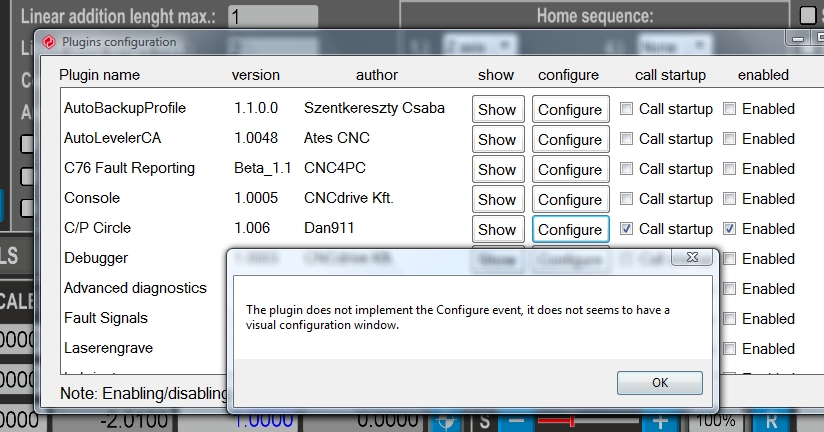

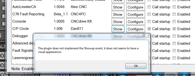

I am having some trouble installing this and I am not sure why.
When I go to the "configure plugin" screen and hit show it says "this plugin does not implement the showup event"
Then I tried to make a macro that would call the .dll using the exec.Pluginshowup ("Cut or Pocket a Circle.dll"); and it gives errors.
Any suggestions on what I am missing, I am sure its simple.

Postby Spuds » Tue Feb 04, 2020 5:20 pm
ejg3855 wrote:I am having some trouble installing this and I am not sure why.
When I go to the "configure plugin" screen and hit show it says "this plugin does not implement the showup event".
Same here Dan.

Postby ger21 » Tue Feb 04, 2020 7:49 pm
I think he needs to recompile the plugin for the newer versions of UCCNC.
Posts: 2810
Re: Create and cut or pocket a circle
Postby dezsoe » Tue Feb 04, 2020 8:54 pm
No, I think it is called by a fixed buttonnumber. If I can recall. :) I hope Dan will come and tell it.
Postby Vmax549 » Sun Jun 07, 2020 8:26 pm
It should use Button # 6333 to start teh Wizard.
IF I remember correctly (;-) TP
