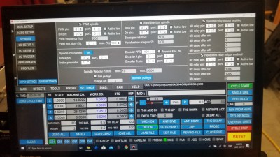

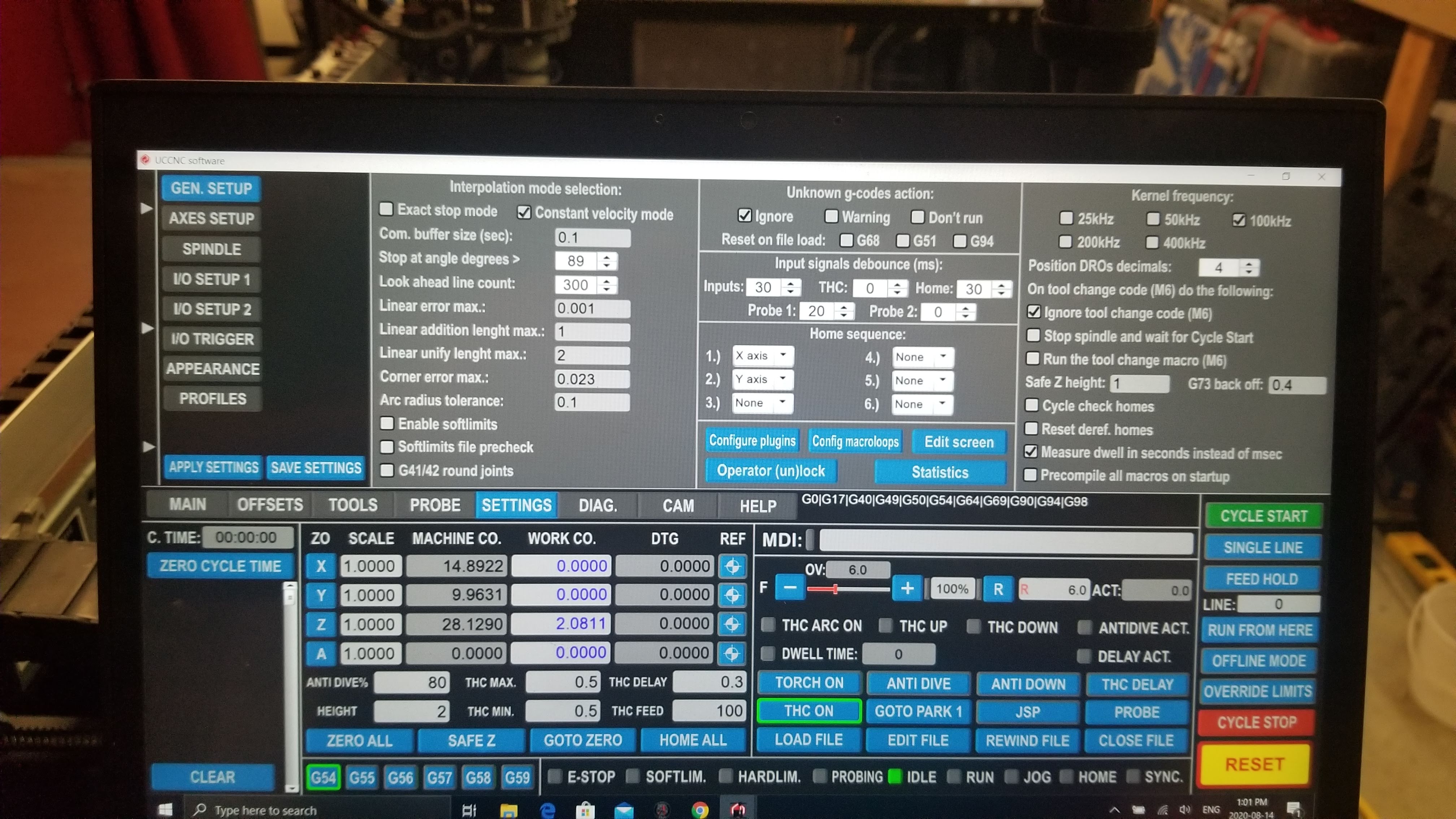

Postby xnaron » Fri Aug 14, 2020 7:06 pm
