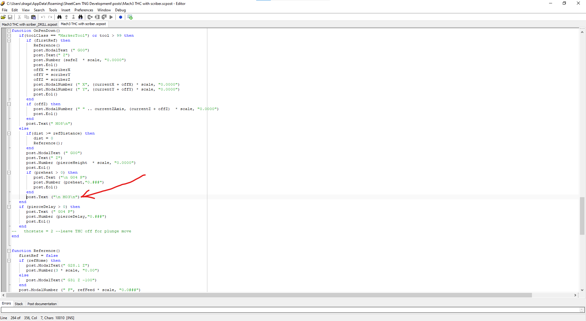

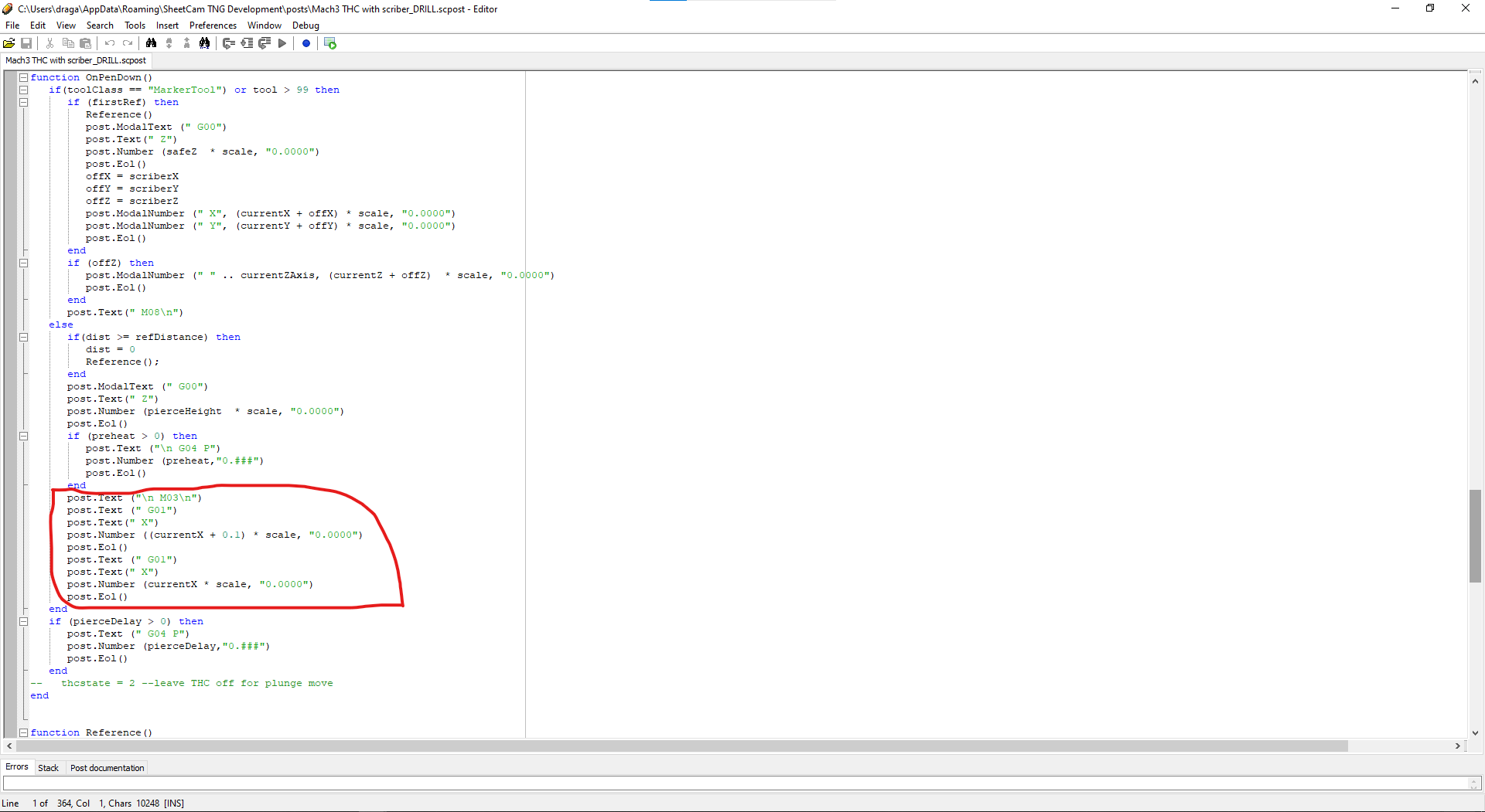

Postby laki » Sat Aug 15, 2020 8:22 pm
I don't know which post processor you use.
I use Mach3 THC with scriber.
If this can help you
In the post processor search
function OnPenDown ()
post.Text ("\ n M03 \ n")
after this add the "movements" you need

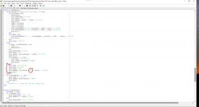

Postby xnaron » Sat Aug 15, 2020 9:52 pm
Thanks. I can definitely work that into my post processor. I will try it and post results. Are you running in mm? I am thinking because I am running in inches I need to tweak 0.1 to 0.001.

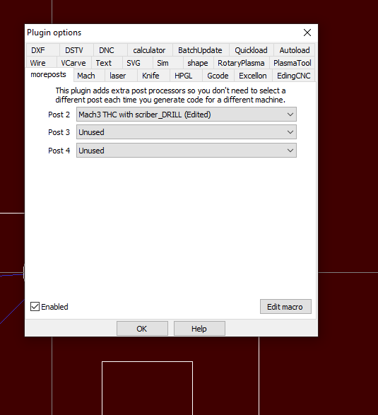

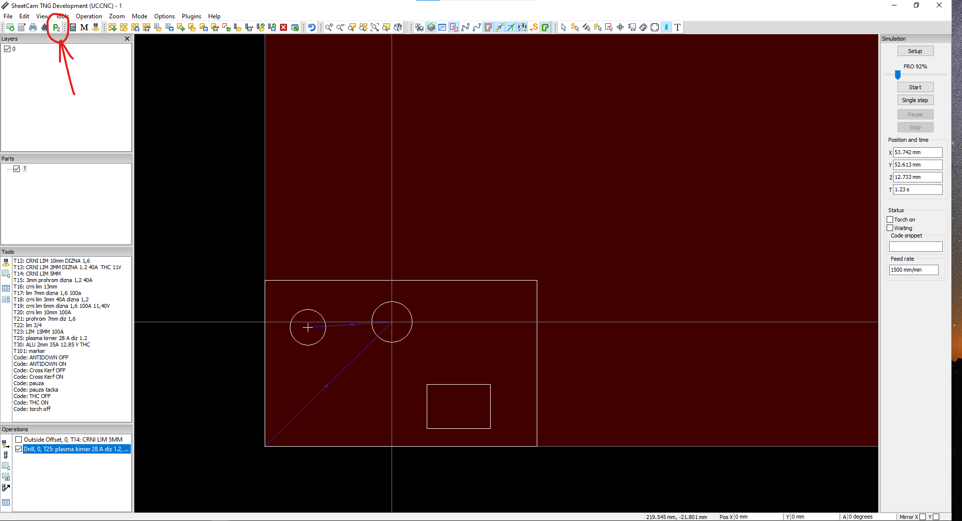

Postby laki » Sat Aug 15, 2020 10:38 pm
I suggest you use this modified postprocessor only for drilling operations.
In SheetCam you have the option to use multiple post processors.
You can add another postprocessor here:
You can use it by pressing this button:

Postby xnaron » Sat Aug 15, 2020 10:56 pm
Can you check something for me. Import this dxf file into sheetcam and then use the drilling op in sheetcam. You will probably need to increase the max hole size in the drilling operation to 3.5mm. Then run it through the post processor and take a look at the results. I made changes like you suggest and the results look fine on a cutting op but on a drilling op they are not right. I tried it with the stable and latest dev version of sheetcam. I am curious if you get similar results with the drill op.
