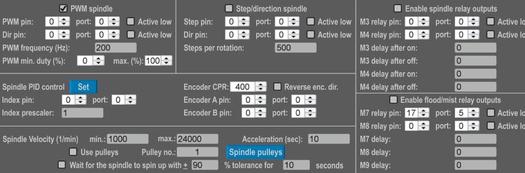

one minor issue: I have a relatively big delay for M5 command.
after M5 command, the spindle keep running for 4-5, maybe 6 sec, then decrease rpm and stop
could be a modbus issue or else? what else?

Postby valhallaCNC » Mon Nov 04, 2024 1:33 am
Goto settings > spindle....there is a delay setting there

Postby sebba » Mon Nov 04, 2024 7:06 am
here? nothing

Postby RsX » Mon Nov 04, 2024 8:48 am
Acceleration (sec)
look here, its function has been changed in the new version
https://forum.cncdrive.com/viewtopic.php?f=3&t=4899

Re: Modbus Master and Haunyang GT series Inverter
Postby sebba » Mon Nov 04, 2024 10:06 am
Great, thank you
