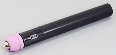

You will have to forgive me if I have this wrong but;
Most if not all of those examples have a shield which is electrically isolated from the arc. Most blow back start.
That sheild can be connected to the ohmic sensor without too much concern.
My torch does not have a shield. Just a nozzle and electrode.
What's more is that the nozzle is elctrically connected back to the cutter. This is the pilot arc circuit.
The maker of the ohmic sensor I intend to use says it will withstand 600volts.
My understanding is the pilot arc is more than ten times that voltage. Again I could be wrong.
Pics are the best I could find of my style of torch.
