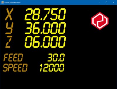

Hi All!
New to the forum, been around CNC for almost 20 years. I'm building a new machine and while waiting for parts to arrive I decided to do a little programming.
You can use an old Windows laptop, desktop or tablet as a remote DRO. (Or even a wallboard with an LCD screen)
This is more of a proof of concept, but it is functional.
Paul
Sorry, had to break up the files due to upload size limitations.
TCPModbusRemote.zip
(217.54 KiB) Downloaded 2044 times

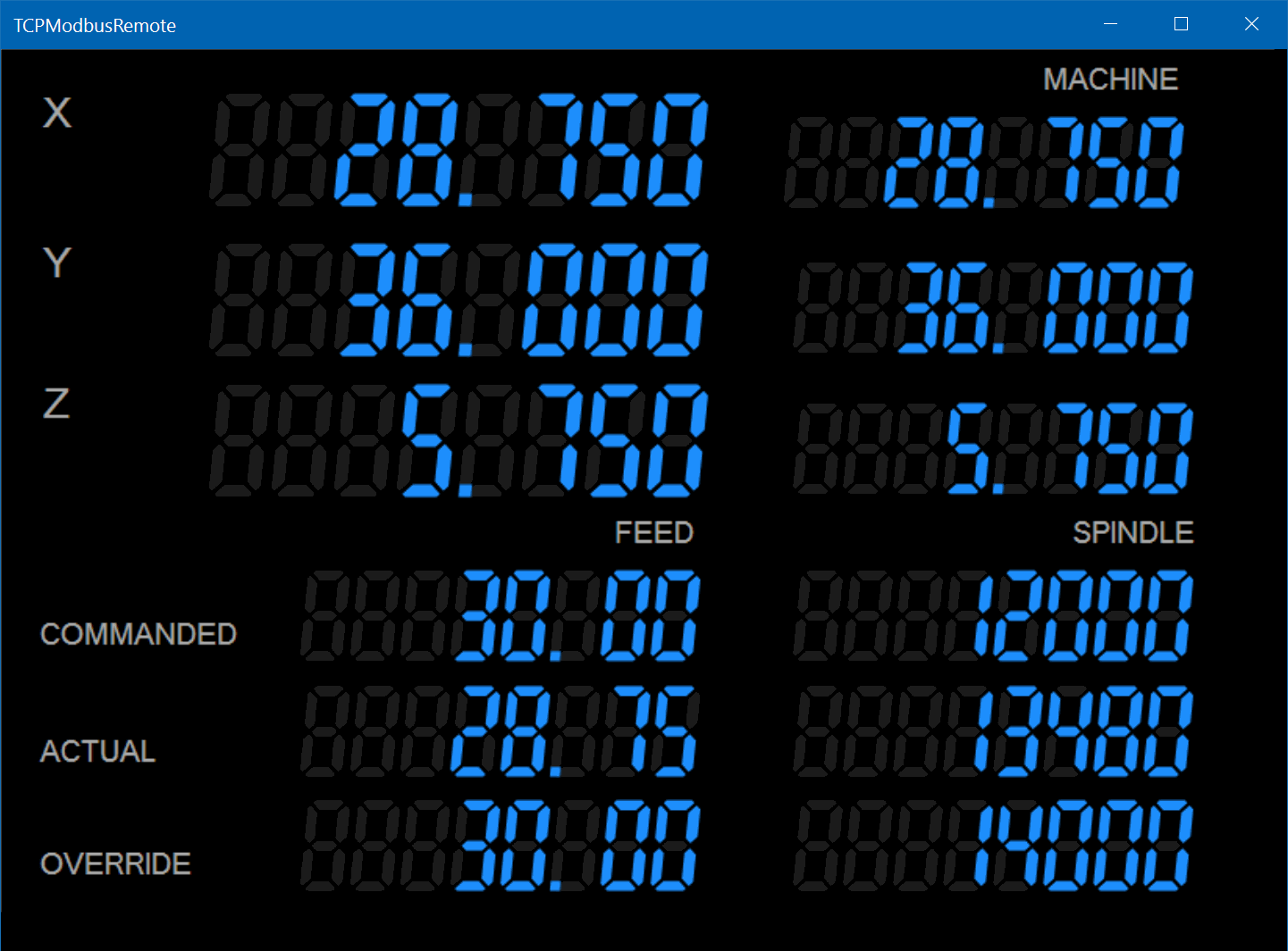

Hello again!
I refined the program somewhat and made it prettier! (I think)
It is now a stand-alone executable without a need for the DLL or font install. It also now runs under the .NET 2.0 framework (same as UCCNC)
README is included in new package. As usual, full source code and example included.
I think the Modbus addition to UCCNC was a great idea. I'm now working on an Arduino Modbus TCP project. :D
Paul
TCPModbusRemote.zip
(186.84 KiB) Downloaded 2072 times
