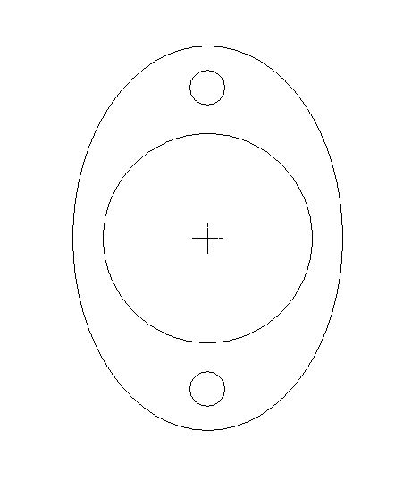

Postby evanevery » Wed Aug 21, 2024 1:39 pm
Not sure exactly what you are asking but I'm happy to help any way I can...
Not sure where to start but I bought a full Motion Control unit from CNCDrive which uses an AXBB-E (and came complete with steppers, power supplies, etc). It uses a 2-wire probe method on the I3 pins. I can provide the schematic if you need it. Both my plates (and chuck/collet clips/magnets) are wired in parallel so if EITHER one of them makes contact, the probe circuit will be closed (activated). Both clips/magnets share the positive lead (I3+) and both plates share the ground lead (I3-). This way I can use either clip/magnet with either plate. The fixed plate is simply attached to the front right corner of my work surface. (The thickness of the fixed plate is essentially irrelevant as long as it doesn't change wrt to the work surface/material).
Does this help?

Postby alen444 » Fri Aug 23, 2024 6:23 pm
evanevery wrote:Pretty much any fixed touch plate will work, you just have to securely fix it to a known location on the worktable. I'm using a laser cut acrylic fixture screwed onto my work plate to hold a pretty common (and cheap) touch plate: https://www.amazon.com/Pieces-Setting-Milling-Engraving-Machine/dp/B08THHMB3Z
Sorry,i didnt explained myself correctly,i guess. Im interested in this quoted part,the laser cut acrylic fixture ;)
alen444
Posts: 6
Joined: Mon Aug 19, 2024 8:09 pm
Re: M6/M31 Macro Pair to emulate Carbide3D Bitzero Probing
Postby evanevery » Fri Aug 23, 2024 8:16 pm
Its just a simple fixture with a hole in the center to match the outside diameter of my "fixed" touch plate. There are also a couple of screw holes so that this fixture can be screwed down onto my T-Track so it doesn't move. The touch plate just sits snugly in the circle.
It could also be a simple router project for a wood holder... (Instead of acrylic)
evanevery
Posts: 20
Joined: Tue Jan 11, 2022 3:57 pm
Postby alen444 » Sat Aug 24, 2024 8:46 pm
evanevery wrote:Its just a simple fixture with a hole in the center to match the outside diameter of my "fixed" touch plate. There are also a couple of screw holes so that this fixture can be screwed down onto my T-Track so it doesn't move. The touch plate just sits snugly in the circle.
Thank you for the inspiration..will try your macho in an upcoming weeks,and report how it operates ;)
