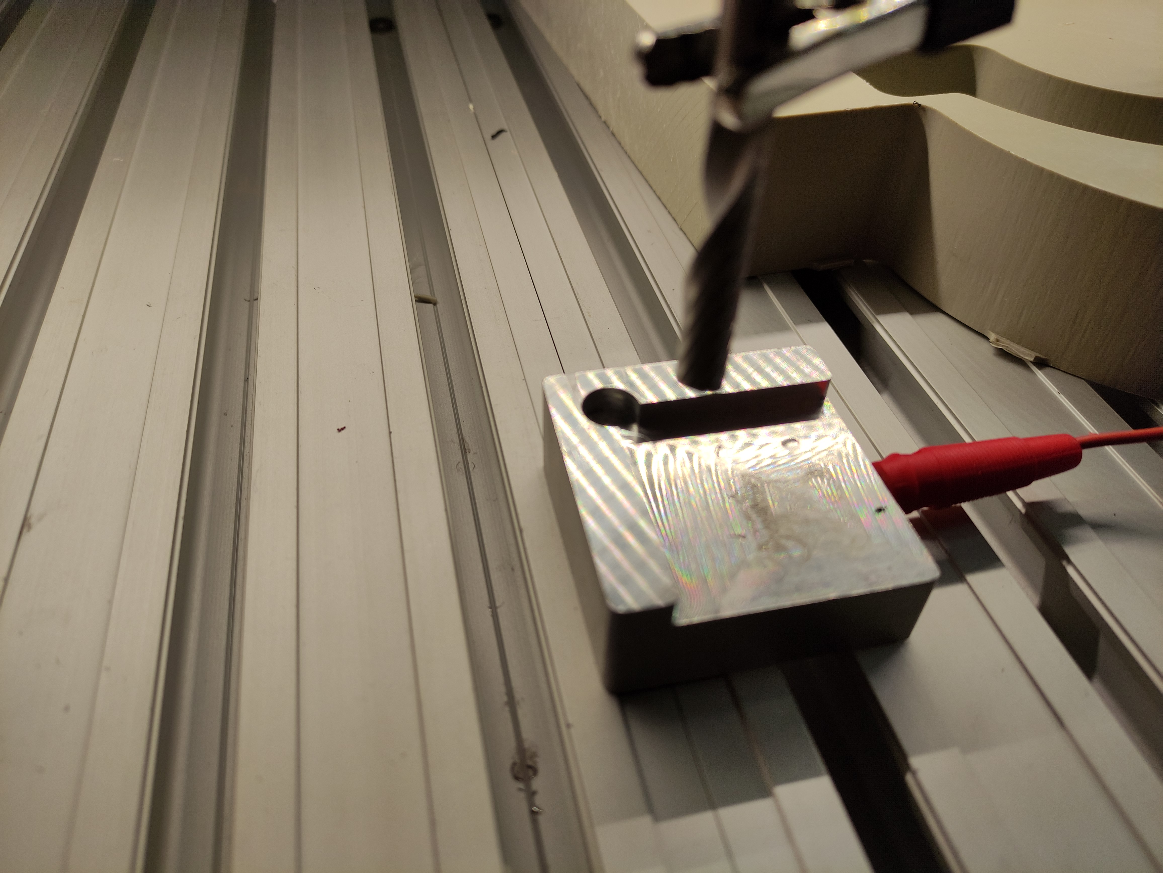

I need help with settings the outer corner probe. Where can I set the wall thickness of the probe if I have for example 10mm on X and Y?
I can't find any information video or anything...

If you want to do it on the probe screen then set Gage height to 10 and turn on Axis 1 count gage and Axis 2 count gage.
