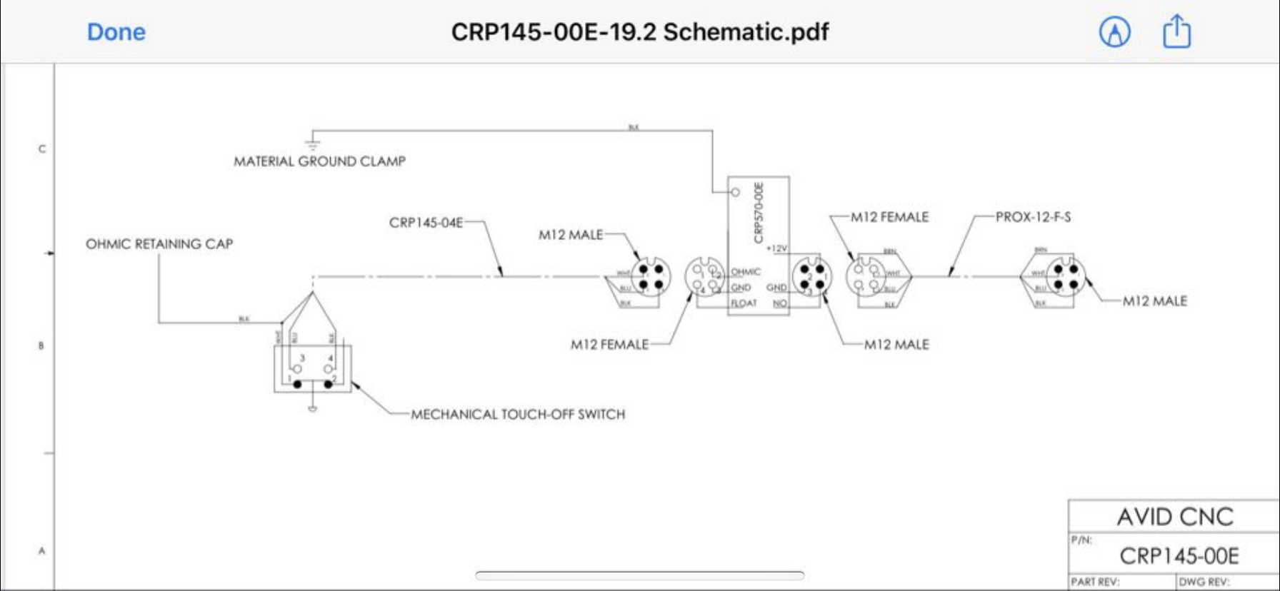

Hey Rob I am wondering if you could possibly help me out with my cnc plasma table. I am wanting to do the same thing you are doing here. I am running a uccnc axbb-e controller with sheetcam. I ordered a ohmic sensor from cnc router parts and somehow it allows to to run the ohmic sensor with a back up floating head on one signal wire. Because the ohmic will be set at zero and running anti collision torch with proxy sense as the back up so it will need an offset for the back up. I will include a pic of the ohmic wiring diagram. Cnc router parts use Mach 4 with there post processor which allows them to run ohmic and backup with 2 offsets on one input signal wire. Pics will be of wiring diagram and the Mach 4 where it shows 2 separate offsets. If you could help me get this set up or help with a post processor that would allow this to happen in uccnc I would be most great full.

Re: Plasma Touch Off Macro for Ohmic and Floating Head
Postby Robertspark » Thu Apr 16, 2020 9:42 am
Werwelding
I've had a look at the schematic. I'm sorry I cannot see any way that Mach3 will KNOW which input has been triggered..... I mean it only has one sensor wire coming back to the machine from 2 inputs so there is no way to know or to test which input has been triggered and apply the correct input.
The macro that is posted earlier requires either 1 input (for the G28 probe) and 1 output to test which input (OHMIC or FLOATING) has been triggered..... without a means to test which input was triggered or by using two seperate inputs (as when I created the macro UCCNC only had ONE PROBE input....... now UCCNC has the option fro 2 PROBE inputs..... so you could check which one was triggered and apply the correct input.....)
If it were me..... I'd modify the circuit so that the ohmic is done by the sensor.... and just use a swich input to UCCNC for the floating head that way you could determine (automatically via MACRO) which input had been triggered and (automatically via MACRO) which Z Offset to apply..... normally zero for Ohmic and a negative value for the floating head given the switch is triggered by driving the torch onto the metal plate and then driving the z below that level to trigger the switch.
Sheetcam can apply an offset within the gcode file but it cannot determine which input was triggered..... that requires the use of a macro to automatically set the correct input.
Sometimes I have crud build up on the cap and the Ohmic will be always triggered (until I clean the cap....)..... if this happened during a cut then UCCNC (via the macro posted above / earlier) will test the input to see if the probe was already triggered and just ignore the ohmic input and run with the floating head...... if the floating head was triggered then it would stop the job and wait for me to manually investigate and sort out the issue.
