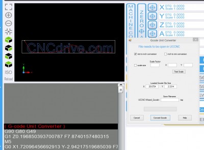

I updated the plugin per Terry's request and suggestions, I think it can be very useful in the rare times that it's needed.
I took a Gcode file created with CnCdrive's free text engraver program, it only outputs mm, I than converted it to inch and scaled larger to my likings. I changed/added a few things such as
a scale preview and a help button to the plugin.
