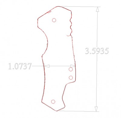

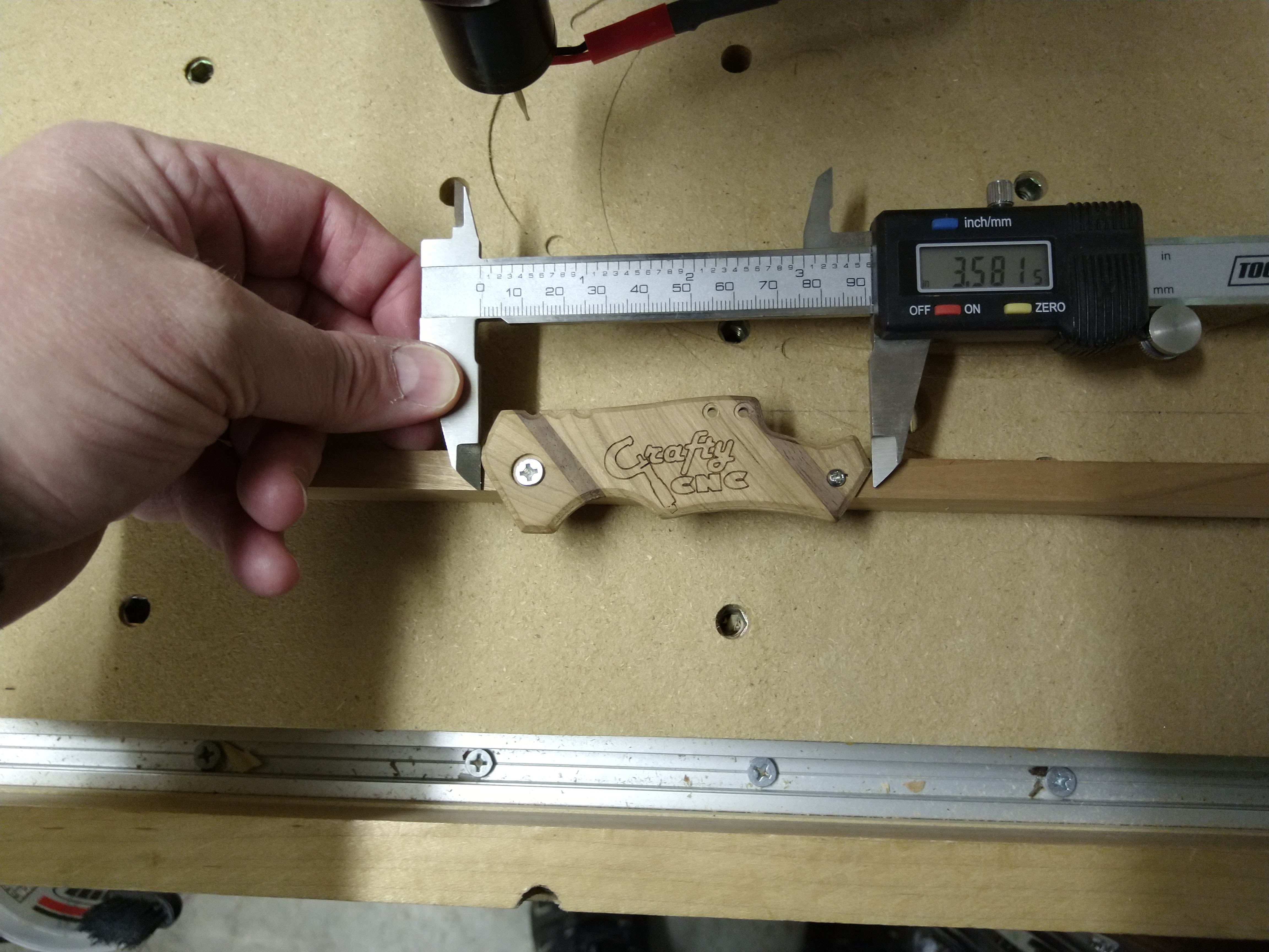

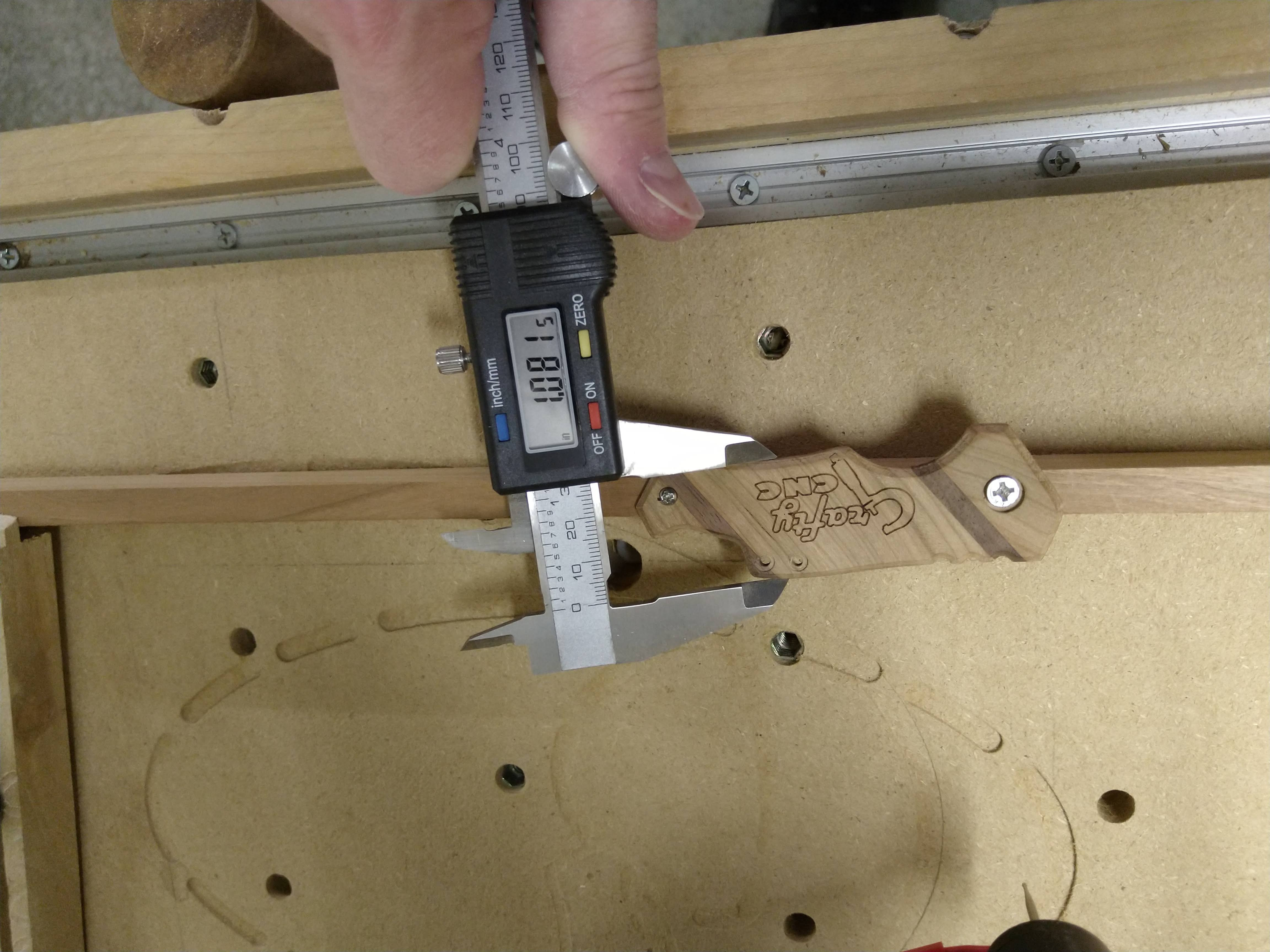

Well, today we got a bunch of snow throughout the day here, so I spent a lot of time working on the ProbeIt re-write for UCCNC (when not shoveling...). Was finally able to get the 2D profile tracing working satisfactorily after losing much hair... but this was the part I was hoping to get working so I'm happy :)
The below video and some pics show a test tracing of a knife scale that I originally made by doing a profile trace by the UCamCopy plugin, so it was a good opportunity to compare by measuring a copy of a copy.
Pardon the poor video and audio, I really don't know how to take decent videos in my shop ....

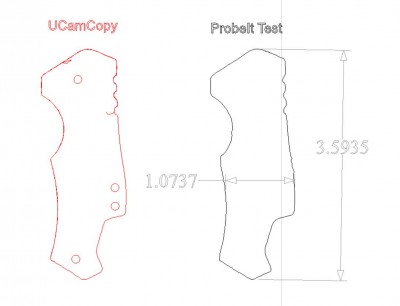

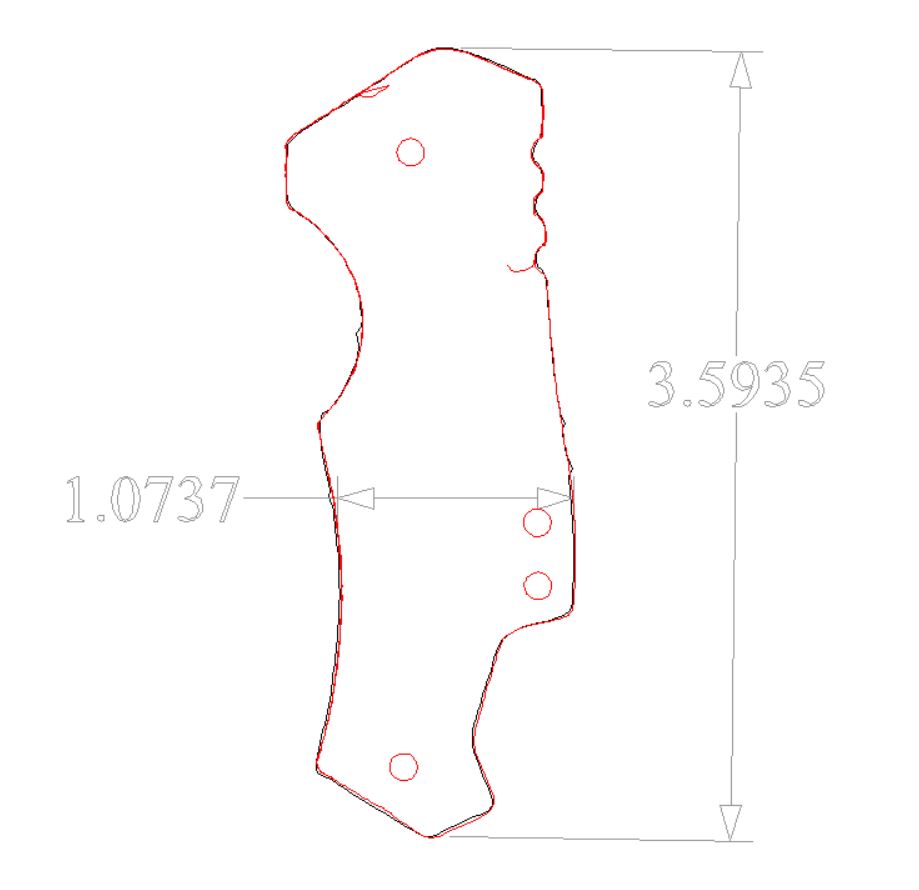

And here is a comparison of the geometry after import into VCarve (no edits, just raw imported DXF)
Compare by overlaying (red is UCamCopy trace, black is test of ProbeIt code)
All things considered, to probe around a piece of wood on a rack and pinion driven CNC router, and get within ~ .010" on 3.6" dimension using a hack of a G31 probe command and with very little tweaking or calibrating shows promise. Now that the basic routines work, the rest is just a lot of cleanup of code and making a usable interface.
