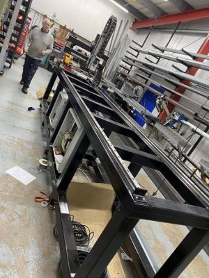

something fun i have worked on for a couple of mornings. can i do this? hold my coffee. lol
my friend has "created a monster drilling machine with no idea how to make it work" he just wants to press one button and the machine does the magic for him. (great brief).
i added some funny messages for him too.
works so far- but he hasnt told me exactly what he wants at each point- so for now its just a peck drill example which he was amazed by.
i will make a simple screen for him so he doesnt get confused!
ive dropped the code below so you can see how you can funk around to get the job done.
if you want to see it in uccnc save it as m20000 in your macros folder and type m20000 enter in mdi.
here it is working on screen. (forgot to video it on the machine) https://www.youtube.com/watch?v=zOdETaYVLVA

Postby Battwell » Fri Apr 14, 2023 9:15 pm
[img]
[/img]
