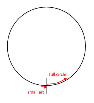

I've attached a small drawing on which the arc startpoint is where the black line crosses the black circle. Now if the circle start point is that point and the endpoint is also that point and a CCW circle is programmed then that will do a 360° circle.
But if the startpoint shifts to the left even a tiny bit then the same CCW circle coded will mean a very small arc which ends at the same point, so only a very tiny angle will be done before the circle code execution angle reaches the programmed endpoint's angle. This difference may be very small 0.1, 0.01 or 0.00000000001 etc. because mathematically with even a minimal shift of the coordinate to the left will change the full circle to a tiny angle arc.
