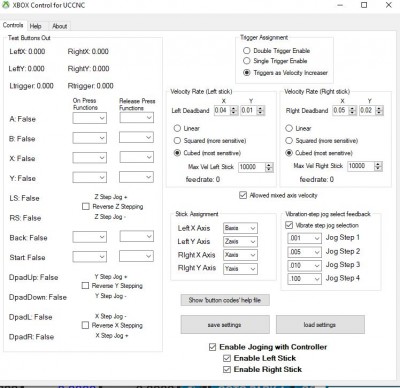

Absolutely correct, the velocity setting is causing the problem. I had on the left stick Z Axis and A Axis. (Changed to B now, to avoide it.)
Speed setting is 10000 and therefore the max speed of 50 rotations is easily reached. Then the controller comes into this error mode.
Frankly speaking, it would be good to handle each axis separte or using percentage values. The Speed limit is also 10000, I would be able to go to 14700. Would be also good to remove this limit.
Hope this helps.

Postby eabrust » Wed Jan 15, 2020 2:52 am
Hi Michael,
Frankly speaking, it would be good to handle each axis separate or using percentage values. The Speed limit is also 10000, I would be able to go to 14700. Would be also good to remove this limit.
Man you metric guys and your complaining about needing lots of numbers to go fast :) Just kidding of course :lol: .
Thanks for your findings and suggestions, I 'think' I've addressed everything that was causing your issue, and made it a little more customizable too. Please take a look at the XBox thread http://www.forum.cncdrive.com/viewtopic.php?f=14&p=18652#p18652, and download the latest version I just put out.
As always, let me know if something seems wrong.
