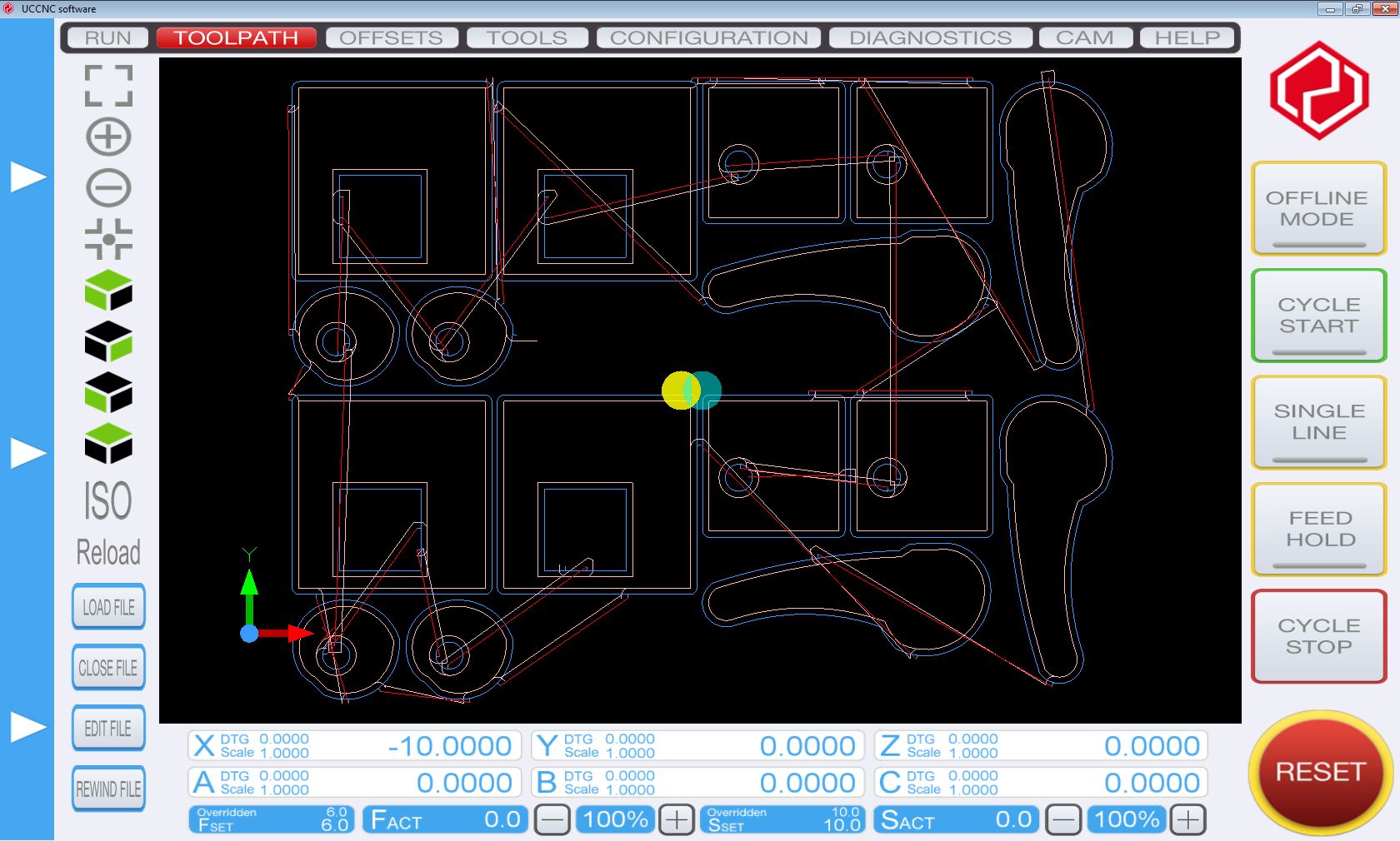

Postby cncdrive » Fri Aug 25, 2017 3:02 pm
I can make an option about the SafeZ, if it has to be in machine or the current coordinate system, but I will need some time to do that,
because we started implementing the G41/G42 tool radius offset and it requires lots of changes in the software, so we had to first freeze all other developments on the UCCNC until this will be finished.
Development going good, but not finished yet. Have attached a printscreen of the development, an test offset path. :)
Re: 2017 Screenset Question - safe Z height
Postby ger21 » Fri Aug 25, 2017 3:11 pm
Looks great!!
