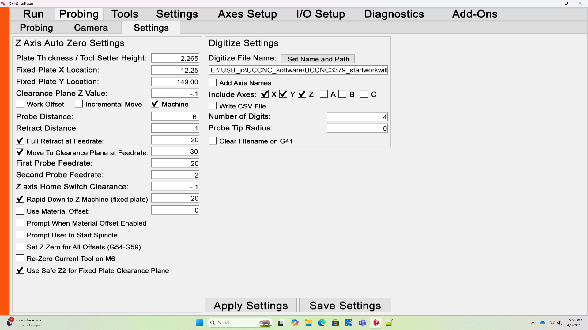

Postby Erphillips » Tue Apr 08, 2025 11:21 pm
I have tried both the Safe Z2 and fixed Clearance Plane,on the clearance plane setting seems that it has to be - Negative value or I get an error message ( makes sense as it would need to be below Z 0.00 )
I just tried all my same settings with version 1.2113 as it was also already installed and working on same computer, same issue
First probe operation works, when it moves to tool setter location Z goes positive to limit
all settings are in inches if it matters.
I will try version 1.2115 tomorrow if you still suggest it,
Thank You
Ed
Screenshot of the last settings I tried, I have tried dozens of settings in various places that appear to have an effect on the Z axis, always same result or a error message popup.
Probe settings screenshot

Re: 2022 Screenset Calibrate Tool Setter issue
Postby ger21 » Wed Apr 09, 2025 1:47 am
What is your safe Z Height 2 set to on the Settings page?
Try unchecking the "Use Safe Z2" box and changing the Clearance plane to -1 instead of -0.1
Posts: 2810

Postby Erphillips » Wed Apr 09, 2025 2:53 pm
Good news
I Found the issue finally
Had to not check the "Rapid down to Z Machine ( Fixed Plate ) 'option in the probe settings I had it set to 20
Just tested it again, if selected it Z goes positive when it get to the fixed plate
Now the Bad news, I should have just been happy but had to try one more thing,
Tried a -20 for the setting and re enabled the check box
Re Homed, ran Calibrate Tool setter it proceeded to detect spoil board just fine, went to the Fixed probe location Z went down relatively fast and totally smashed / destroyed both my 3D Touch probe that was in the spindle and the fixed probe sensor on the table and jammed the Z ball screw very tight.
Very expensive lesson learned, don't set that to a negative number!!
Now to Buy and wait for new sensors to get here so I can keep going on my ATC setup.
Postby ger21 » Wed Apr 09, 2025 4:08 pm
When you select that option, it has to be a negative number, as 0 should be the top of your axis, and it will always do what it was doing if it's positive.
But it's extremely important that you know that the value you set will never cause a crash.
Sorry I didn't catch that yesterday.

Postby Erphillips » Wed Apr 09, 2025 7:06 pm
Okay so "Rapid down to Z Machine ( Fixed Plate )" is a distance not a speed
Makes perfect sense now, not sure why I thought it was a speed override to Rapid down not a distance to travel from Machine 0.00
one would still think if the probe was activated during this move it would stop not just keep going to in this case 20" below my home position
Manual literally spells it out and explains the consequences of setting it wrong, I do see the value in the setting as it takes forever to go from my Z 0.00 ( Safe Z ) to the top of the fixed probe at 10 ipm
My bad for not reading the instructions better, I learn best by doing vs. reading sometimes it cost me, But I bet I never forget it now!
Rapid Down to Z Machine
This option is used during tool changes, and Tool Setter Calibration. When selected, prior to probing for
the fixed tool setter, the machine will rapid down to the specified value (in Machine Coordinates) before
starting the probing operation. This can greatly speed up the probing process, by shortening the probe
distance.
Warning! Incorrect settings may result in damage to your tools and/or machine. If this option is selected,
make sure it's location provides sufficient clearance with the longest possible tool used.
Postby ger21 » Wed Apr 09, 2025 8:12 pm
It's not a probing move, it's a rapid move down.
