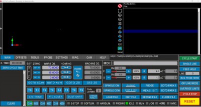

Postby bhdavis » Sat Aug 24, 2024 3:43 pm
Thought I'd post my newly completed screen. It's for a 6 position tool changer. There is also an extending table for the tool rack, a retracting dust cover over the tool rack and a lifting dust skirt. UCNCN 1.2113.
Contract me if you would like copies of the screenset, screen or profile files used. I tried to attach the .ssf screen file but got a "file too large" error message.

Postby Algone » Sat Aug 24, 2024 7:38 pm
Very nice, good job.
