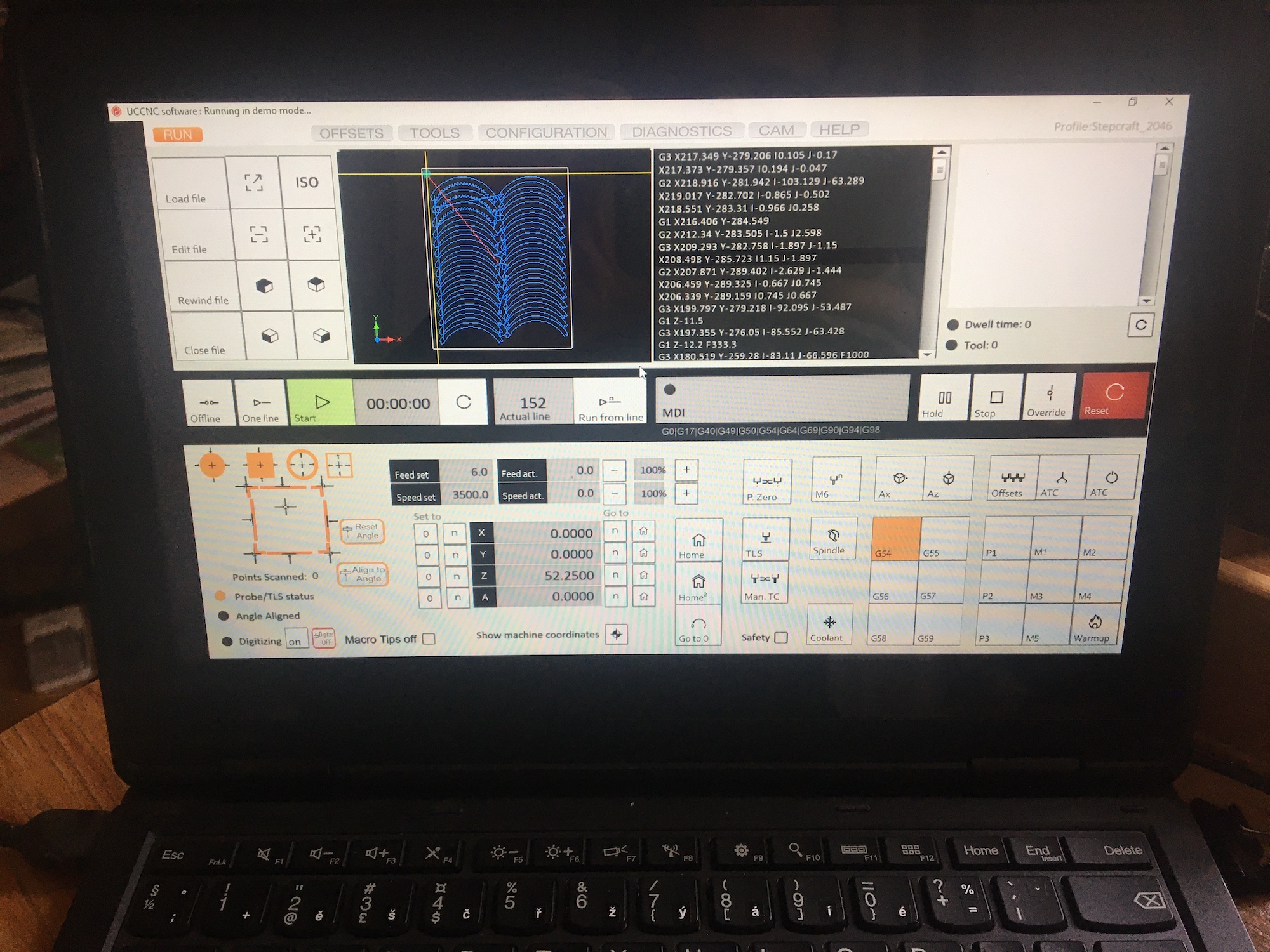

Hello there,
I have been working lately on a UCCNC redesign, as the actual Stepcraft UCCNC is super clumsy.
The Actual design follows no UI rules, the text like
H
O
M
E
..in UI design is unthinkable, text does not have high enough contrast, it is hard to tell what is active as the colors used emphasize the buttons themselves screaming one over the another for our attention without actual purpose – and it gets worse exponentially the further you are from screen. The buttons have no seaming logical grouping and many of the buttons are hard to press on touch screen. Stepcraft two logos OMG! occupies needed space for the UI, and so on and so on.
The new version I'm working on address all those issues and more. All the function stays the same, there are no extra buttons. I also tried to keep the buttons more or less on their actual position if it was feasible.
Now, I would like to hear your comments before I start to do final adjustments.
Let me know if you see any problem and basically anything I overlooked.
As I said it is alpha a not polished.. that will come at the end, now it is about the layout, overall clean up and quick intelligibility foremost.
thank you for your comments in advance.

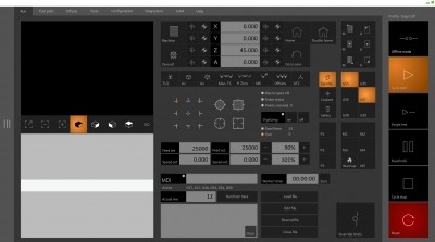

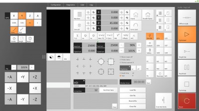

Here is a new version, with feedback in mind.
The MPG/JOG is bit clumsy still.. this part of the interface absurdly makes the less sense of all. The functions are hard to understand as they inherit one another (continuous, MPG Continuos, Multi,... this to me is unnecessary overkill..).
MPG/JOG
Main UI
2046

Postby 2046 » Tue Mar 01, 2022 12:54 pm
I've been trying not to.. but I kinda gave up.. at least Dark mode for comparison.

Postby 2046 » Tue Mar 01, 2022 10:24 pm
yet another dark mode version..
a result of a free style run.. the ui icons and the elements positions is getting cleaned up more and more. Will see where this will all goes.

Postby 2046 » Fri Mar 04, 2022 10:19 am
Oki.. I went back to machine and saw the mess the actual UI has in reality again.
And so I decided to do it right without trying to match what has been there.
This is the layout I'll turn to reality.
All buttons have decent size so that they can be pressed by finger, and if they are small they have space around that helps us not to press anything else around. Although dark version looks fancy the screen is light as that gives it the best readability.
The layout is done with logic in mind, meaning.. there is clear division between probing group, main controls, view/read screens, macros, and so on and many more. That will let us stay on a same spot without need to crawl and look for buttons here and there while doing specific tasks.

Postby 2046 » Mon Mar 07, 2022 9:11 am
Here is the progress, looking good so far, but few details.
heaving the whole UI done in OpenGl is quite weird thing, it will never looks good, plus it is a bit CPU hungry I found lately.
What I mean by that is that all the texts are rendered as images over a 3D polygon and blurred obviously by anti-aliasing. Input fields are basically transparent and need their image representation behind.. all of them, which is insane! The plain text is never plain text, so that you have no chance to copy paste anything from Gcode reader and so on.. super weird.
I kinda understand that it is a CNC standard as Mach 3 has something like that too, but it is super weird nowadays to see such interface.
Anyways.. here is the picture from progress. The probing is a mess (it is all in progress still) but the whole ui is already much better and than it was.
Couple more hours/days and it should be good to go.
