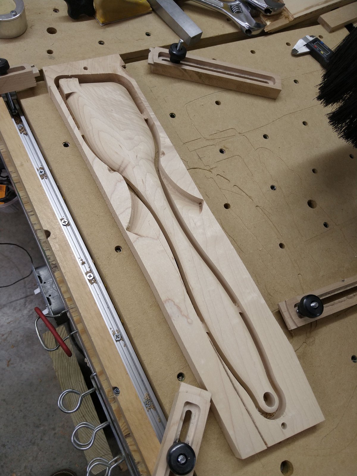

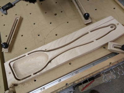

I got making some big 18" long spoons in maple and cherry (based on a Vectric forum posting https://forum.vectric.com/viewtopic.php?p=209289&sid=bada93be19a7454d836e4dcd19dbccea#p209289), and made some modifications to the files to make a flatted spatula/spoon. The flat spoon winds up getting some work on the belt sander to blend out the chunk left near the pointed corner, as its faster to manually sand it off.

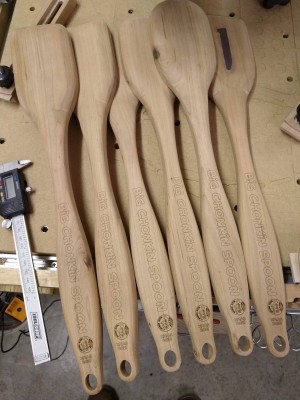

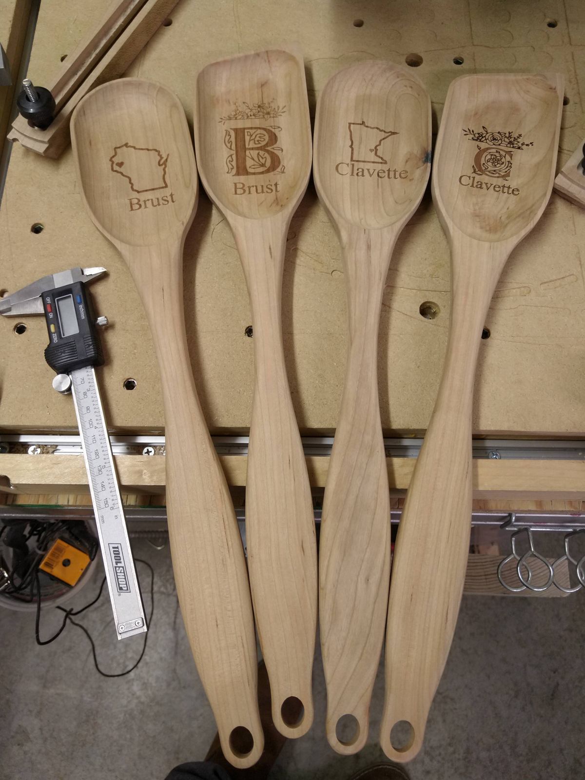

Seemed like a neat gift idea, so I made a bunch... Left the artsy designs in the 'bowls' to the wife, and I marked the rear of the handles for fun with the kids input :) :
If anyone is interested, I could post VCarve or GCode files. Only two bits used are a 1/4" flat endmill and a 3/16" ball endmill.
