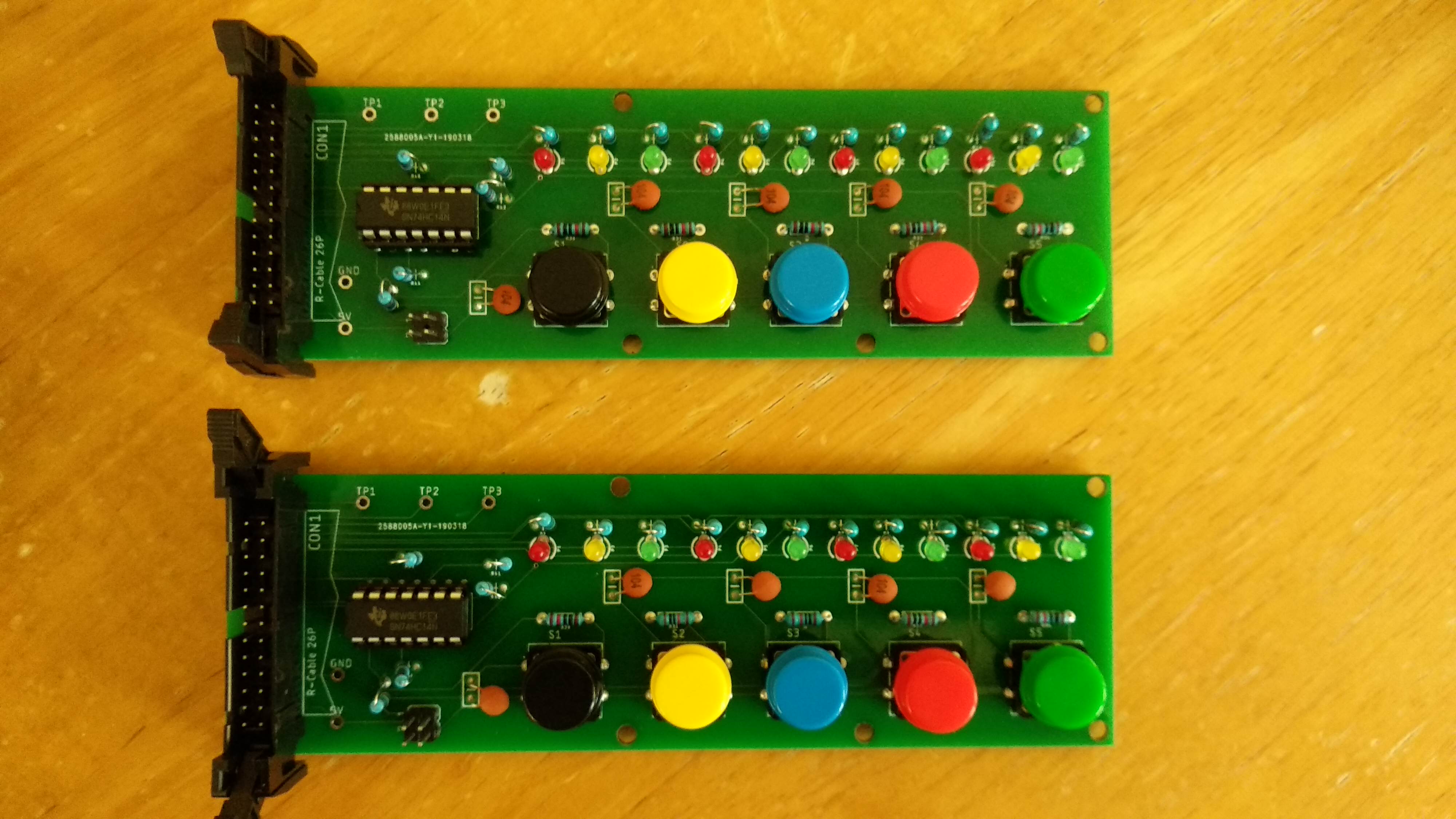

I have a spare uc400eth and given I spend evenings doing macros wizards and the occasional plugin, I've been dabbling with the thought of making a lpt test board / emulator, hence this is what I came up with.
PCBs are so cheap to have manufactured now I can't see the point in milling them any more.
Like I design most of my PCBs given you end up with more boards than you may need, I try to design the multi purpose .... Sometimes this means I make them mirrored so I can install components both sides of the PCB... Like I did with a steering wheel that had button controls and paddle shifters..... And in this case I designed the boards with jumpers so that the buttons can be set as active high or active low to emulate no or NC switches and inputs.
There are also a couple of dedicated test points which I'm awaiting some loops to install in so I can connect oscilloscope probes to or frequencies counters etc and made the programming of macros, wizards and plugins a little more easy to do sat away from the machine or away from someone you may be trying to help.
