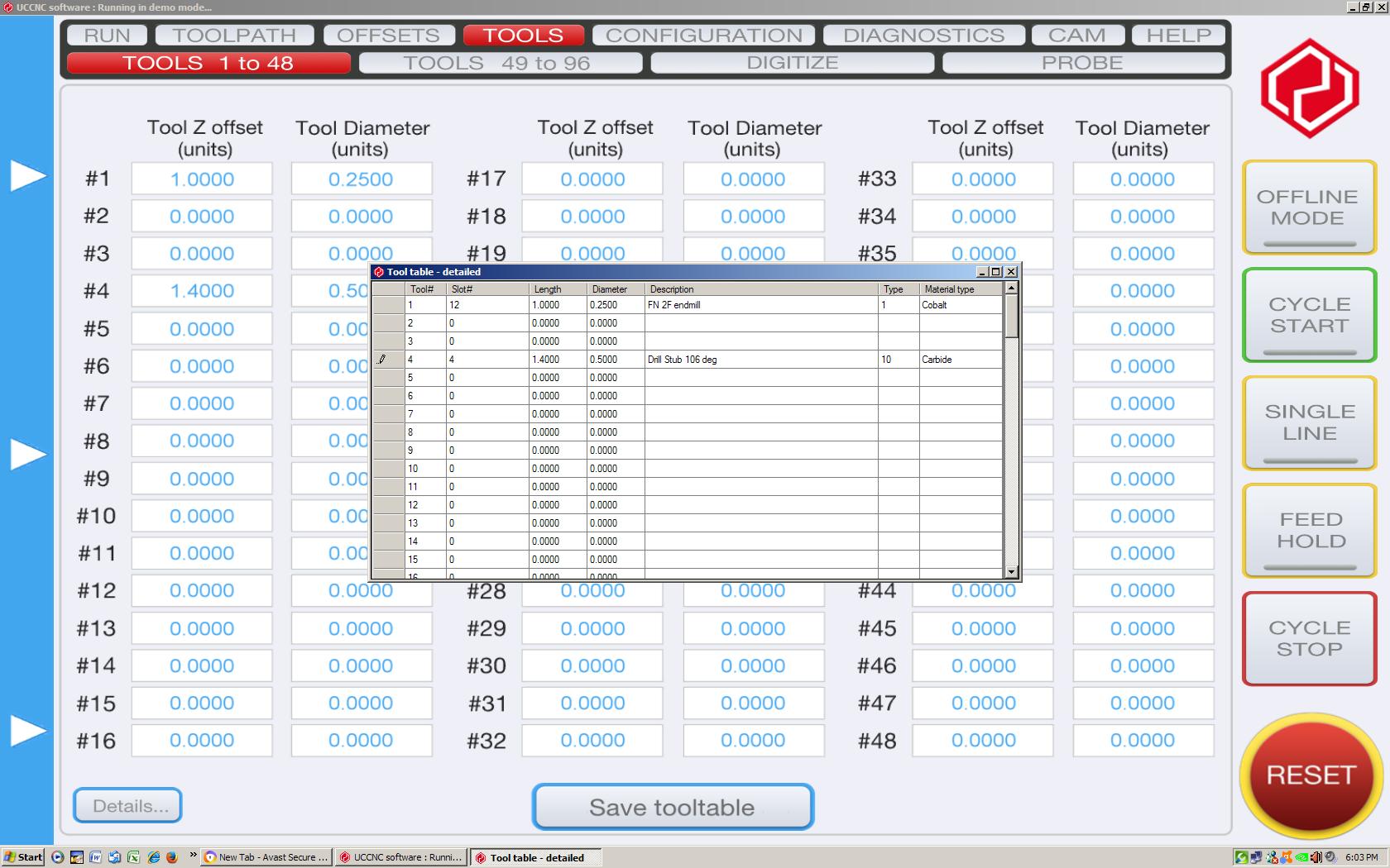

Re: Highly Modified Taig with R8 Spindle/PDB and DMM 750W Se
Postby Vmax549 » Wed Mar 13, 2019 10:16 pm
OK It took a couple of all nighters and many pots of coffee but it is possible to do slot# assignments in UCCNC. You use the stock tool table AND you do NOT have to modify the screenset so it can be used on ANY screenset.
Teh M6 can take the data and rotate the carrosel to the proper tool based on it's slot# assignment.
In UCCNC you simply call a tool# as normal and the script does the rest. Which makes it easier on teh CAM side when creating programs. Both tool table can be exactly teh same . I also did a tool table import / export to be able to SYNC teh 2 systems CAM/Controller.
It will HOT SWAP as well for a dual arm ATC.
It took a while and was like cooking a TurDucKen or making a couple of laps around the moon just to get next door BUT it does work now ;)
So when you get the ATC up and running we should be able to fix you up.
JUST a note I have programmed 3 different type of lathe tool turrents for UCCNC so far. :)
(;-) TP
