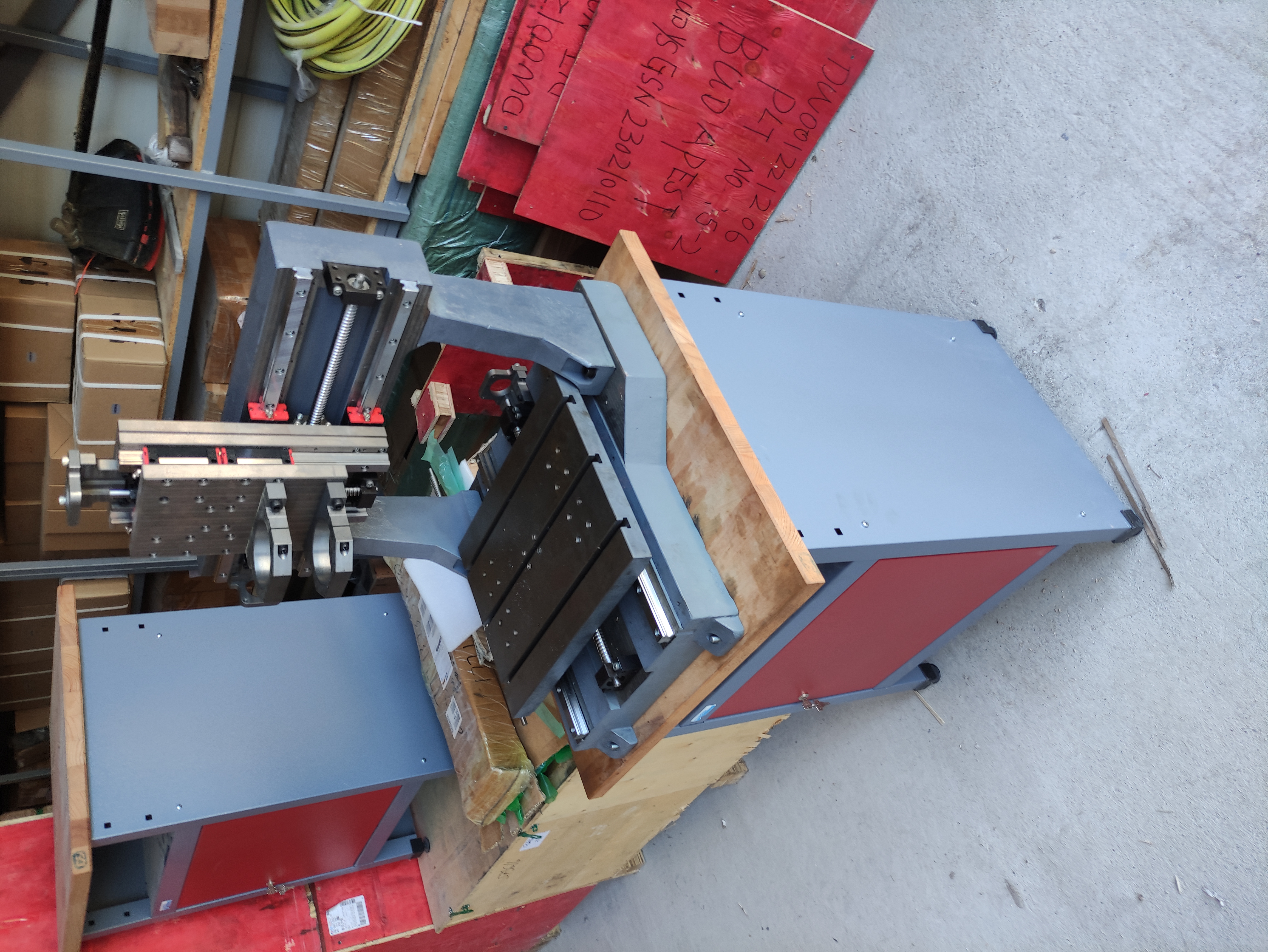

Our 300x400mm machine looks like this.
We just assembled a few of them. :)
The machine weight is about 200kgs, the body is made out of cast iron.

I'm assuming these new machines will run an axbb-e?
If so would it be possible to do some videos showing you setting up the CV settings that work best for that machine (and maybe your another build?)?
I know these are documented in the manual but it would be great to see some before and after changes on a real machine, your thought process etc and from your point of view.

The smaller machines will run the AXBB-E, but the largers will run with the UC300ETH-5LPT + UCBB, especially the one with ATC function as it required lots of I/Os.
The CV parameters are tuned for the jobs not to the machine, but these machines are designed for harder materials, so low CV settings will be more optimal like 0.01mm tolerance or so.
And we will make some demo videos as soon as the control box will be installed.
