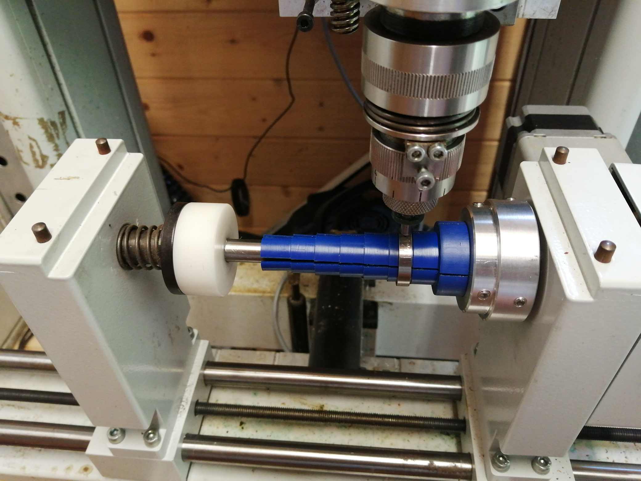

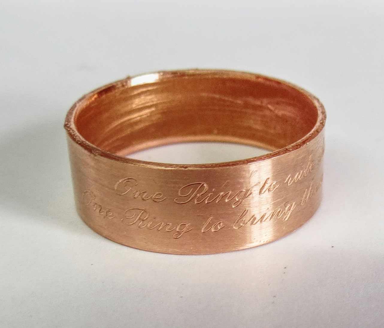

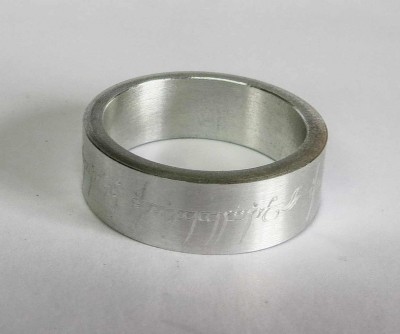

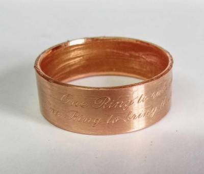

I've managed to sort out the 4th axis on my AXBB controlled rotary engraver and made a fixture to hold rings for external engraving, works very well. Photo shows the fixture and two test rings made from copper and aluminium tube (I'm not going to try any precious metals yet and copper is about the same hardness as annealed silver according to my daughter). The engraving was done using a 120 degree diamond drag point that is very well used but even so I' very pleased with the results, I'm finding UCCNC easy to work with and the AXBB is a great bit of kit, pleased I decided to build the controller around it. Got a new 90 degree diamond tool on the way, should work better that the one I used.

The text on the copper ring has capitals that are just under 2mm high, which gives some idea of how fine the engraving is.
