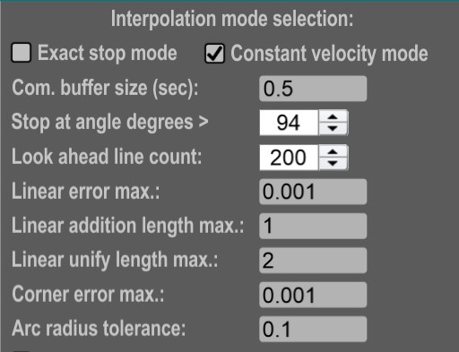

Hi all,
Not sure why I can't get this working on long straight segments. In G86 mode but the machine stops at each segment of a large curve. And, the various settings - linear error max, etc. - are greyed out in settings. What am I missing?
Michael

Increase the error tolerance values in the CV settings.

I would like to change settings in the "grey" fields. I have some recommended settings I want to try. But, when I enter a new value - say 0.005 in "Linear error max" - click [APPLY SETTINGS] and [SAVE SETTINGS] then quit and restart UCCNC, my changes are gone.

Hit the ENTER key after entering the new values.

Right. I thought I was. Having tried again, I now have the setting saved across multiple restarts.
Thanks for your kind responses to a remedial question.
