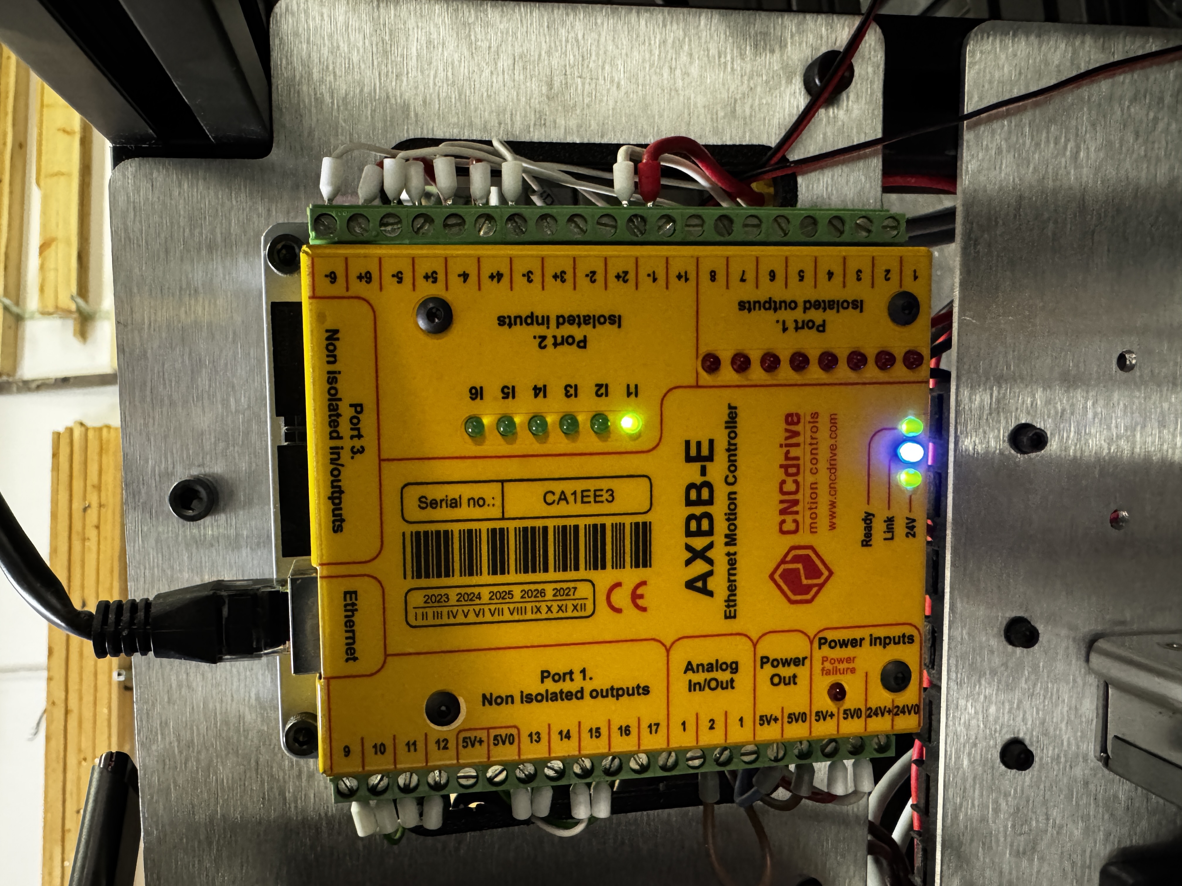

I’m setting up auto-squaring for a dual Y-axis gantry using UCCNC and an AXBB-E controller. A is slaved to Y, and both sides of the gantry have inductive proximity sensors (Huchoo SN04-N) installed for homing.
The issue:
• Both limit switches function and light up when triggered.
• I’ve swapped them around, and they both work fine on the Y axis.

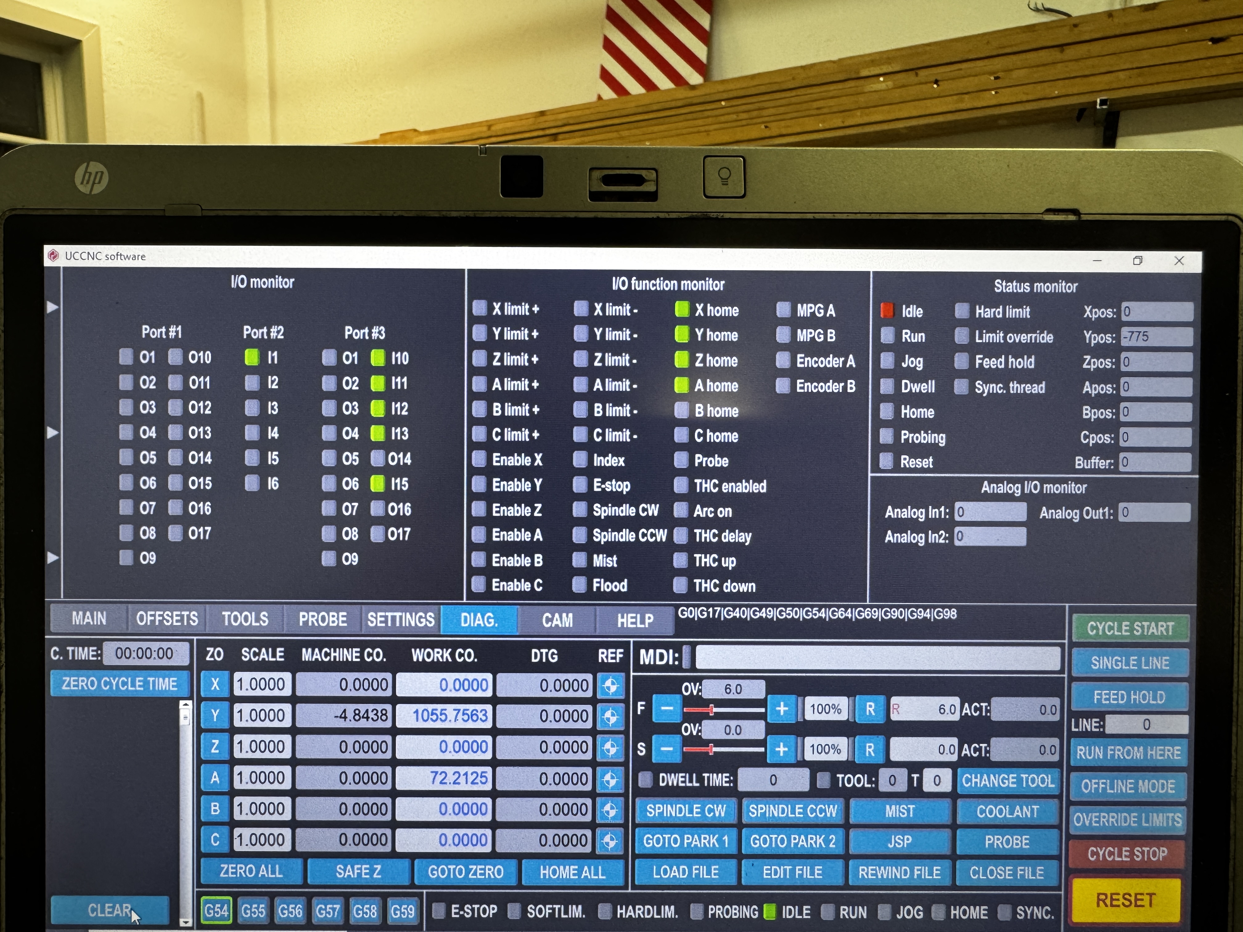

• But when wired to the A axis limit input (Port 2, Pin 3), UCCNC doesn’t register the signal — no response in the I/O monitor.
• I’ve verified the port and pin settings, and “Active low” is enabled.
• The input pin is definitely working — I tested it with the Y switch and confirmed it triggers correctly in UCCNC.

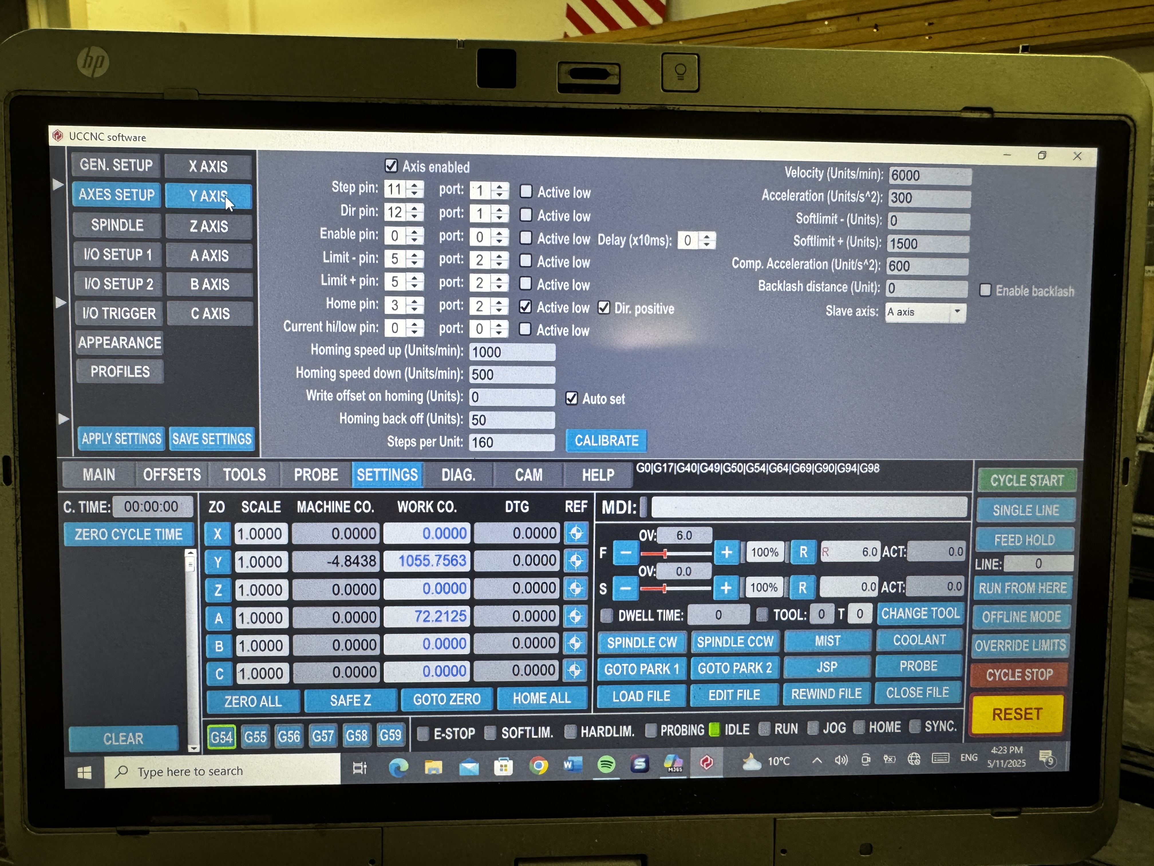

You just have to set the home inputs as per your connection and if it is a master/slave axes pair then it will automatically square the gantry.

I understand UCCNC should automatically handle gantry squaring if both Y and A have home switches set correctly. The problem is: UCCNC does not detect the A axis home switch at all, even though:
• I’ve confirmed this pin works by testing with the Y switch.
• The limit switch (Huchoo SN04-N) is functional — LED lights up and gives proper signal (tested with multimeter and when switching to another port).
• The input is set to “Active Low,” like the Y switch.
• Yet in the I/O monitor, triggering the A limit switch shows no change, while the same switch shows input when used for Y.

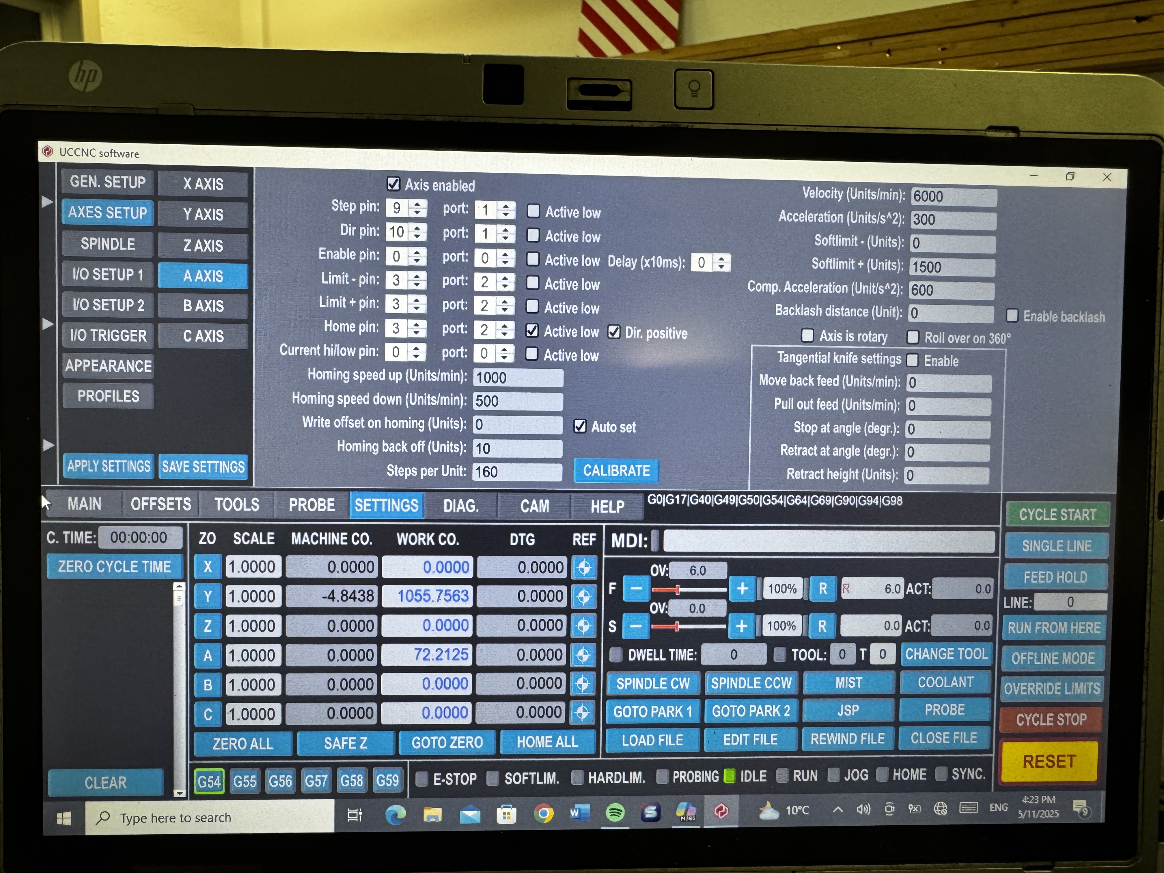

I'm a little confused. Are you saying that port 2 pin 3 does not work with any switch?
You have both home switches set to that pin.
Have you tried some other type of switch on that pin?
For homing to work, the two home switches need to be on different pins.

Another possible problem could be if you mix up the Y and A and setting the Y home switch for A and the A home switch for Y accidentally, so please verify that too.

Postby TheG » Tue May 20, 2025 4:58 pm
Guys,
I found the problem, its not a software issue but I hadn't connected the 3+ input on the AXBBe... Figured it out after a while when I saw the other limit switches had the second connection.
Thanks anyways!!
