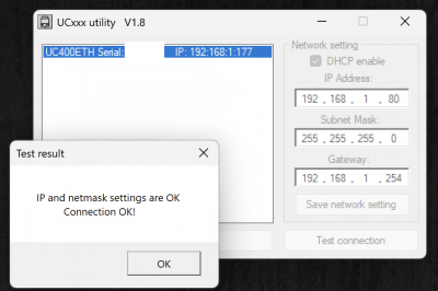

When I run the UCxxx utility program, this is what I see, and is probably why I get the controller listed twice:
The only thing I can do is reboot my PC, after which I run the utility again and the controller is shown only once, and I'm not prompted for the controller type.
Interestingly, the scanned IP address is different to the actual IP address, which I find puzzling, to say the least.

I have a hub in my workshed which is hard-wired to the wired network in my house, so Yes, I'm using a switch. The laptop (for internet access) and the UC400ETH are plugged into that, so I don't see multiple routes being possible? If this were the case, why does a reboot 'clear' the problem?
When I Test Connection I get a positive report (even when two are showing):
Should I change to the correct IP Address and save the settings?

The scanned IP address can be different but in range with the network mask because you have the DHCP enabled, then the computer assigns the IP address to the UC400ETH based on the set IP and the network mask.
