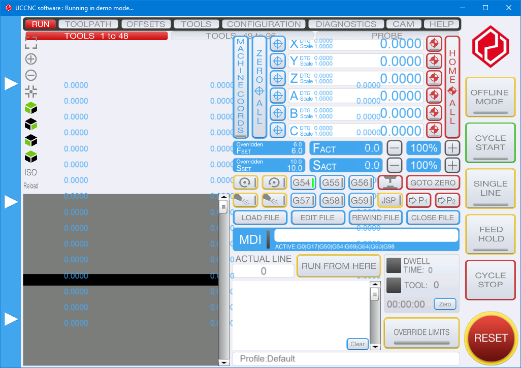

Yes, it's true, but if you call AS3.selectlayer, then it will not select the parent layers. His problem is that in the screen file there are selectlayer calls and when you select a sublayer without selecting the parent(s), the screen will be a garbage. Run this macro and you'll see the result:
AS3.selectlayer(46);

Thanks Rob for your drawing, but i know the structure of the layers well enough. Maybe i didn't explain myself clear enough. The file was only to show you the issue. The layer structure of my screenset is more complex. Here is an example. Let say we have this layer structure:
Tab 1 on Layer 2, with Parent Layer = 1.
Tab 2 on layer 21 is a child of Layer 2.
Tab 3 on layer 22 is a child of Layer 2.
Tab 4 on layer 3, with Parent Layer = 1
If in screen edit mode you select Tab 4 (layer 3) and save the screenset file, when restart uccnc on tab 4 you'll see tab 2 and 3. I need that the two child layers 21 and 22 are visible only on layer 2, for this reason they are childs of layer 2. Thanks

Hi Gerry. I'm gonna explain me again. Let say we have screen layer structure.
when you save screenset file with Layer 2 selected you have:
//Select the startup layers for the main screen
AS3.selectlayer(21);
AS3.selectlayer(2);
but when you save the screen file with Layer 3 selected you have this one:
AS3.selectlayer(3);
Like you can see for some reason uccnc puts the layer 21 (child of layer 2) over layer 3. This issue is when you have child layers on layer2. I thought that uccnc puts the last selected layer over the others and on restart uccnc you'll see this layer only.
