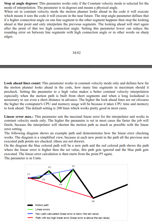

Yes, but you need to adjust your CV settings. There are 5-6 settings that can be adjusted.
Re: UCCNC does not move the spindle smoothly
Postby Robertspark » Thu Nov 09, 2017 11:55 am
as attached
