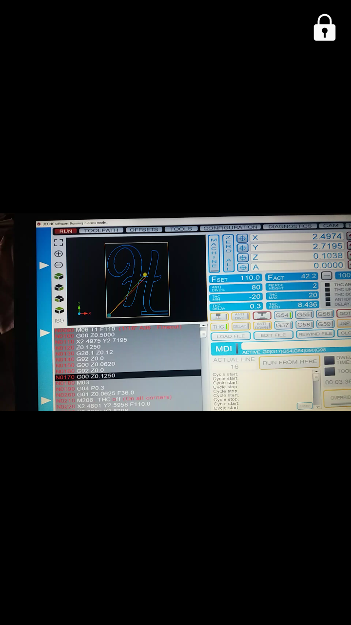

Hi, i'm a new user of uccnc and still fairly new the cnc world. I have encountered an issue that may not be a bug, but could be an error on my part.
I have been trying to adjust cv settings while having a file open, when i apply & save my settings and go to run the file at about halfway through running the file the drawing goes completely yellow and the machine runs totally off course not following the path, cutting accross the workpiece (i run plasma) and basically spoiling the job.
I notice this only happens while i have a file open, if i close then reopen the file before i test my cv settings it cuts fine...it seems
Whats happening here? I am running a laptop with the uc100 and using sheetcam. Thanks in advance

Thanks, i would try to post the file when i get home to my pc. I tried posting a video but it was too large, so attached some screenshots of the video, it shows how it starts off normal but then (almost immediately) jumps to almost the end of the cut while leaving the torch on, and then ends the cut normal.
It randomly does this meaning somtimes the job run normal and then sometimes anywhere along the cut path it goes crazy

OK, I see, thanks for the informations. And this issue happens when/after you change the CV parameters, Apply settings and then run the code?
It would be really helpful if you could post this g-code file and your profile file and also tell me an example of how you changed the CV parameters or if any changes do this issue?
I mean I have tried to reproduce the issue already with random g-code files and random CV changes, but could not reproduce the issue yet, so it could help if I could test with your g-code, with your settings and with similar changes that you did, then hopefully I could reproduce and then debug the problem.
