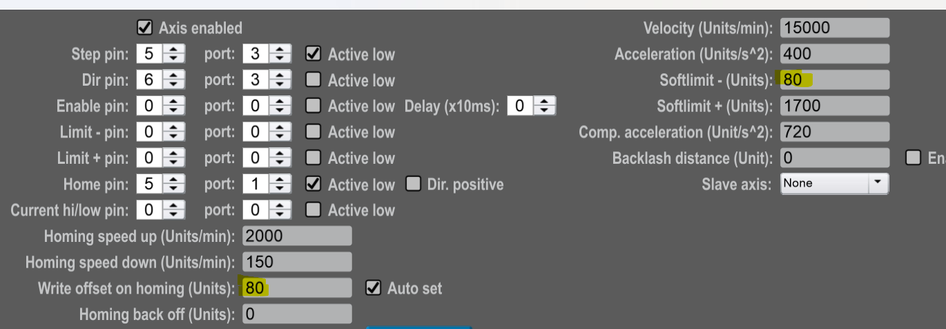

Hi.
When you enter a positive value in "Softlimit - (Units:)" and click "Save Settings", it automatically writes the same value in "Write offset on homing (Units):".
This does not happen in software version 1.2117.

Which axis is it and which motion controller are you running?
I quickly tried it with UC100 screenset and it does not happen, so please tell the motion controller you running hte UCCNC with?
