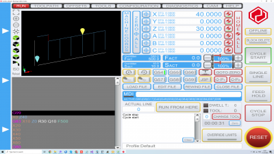

Postby cncdrive » Mon Nov 27, 2023 10:03 pm
It works fine at me, it does not rapid at all:
