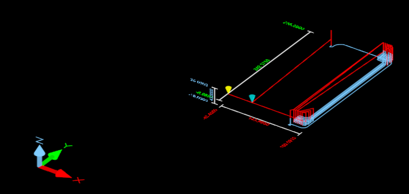

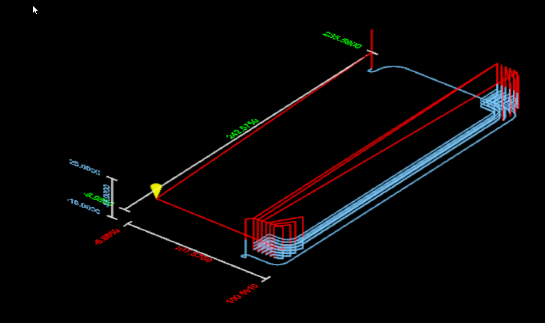

I've just installer the latest beta, and the first thing I noticed is the new Tool Path View rendering system produce a kind of ugly picture compared to the 1.2115 version.
With multi-sampled value set 0, it is barely unreadable, and increasing the multi-sampled value just add a nasty blur. It looks like the framebuffer size is not set correctly, or something like that
Here is a screenshot from the previous 1.2115 version

Here the new version with MSample=0
v1.2116 MS 0

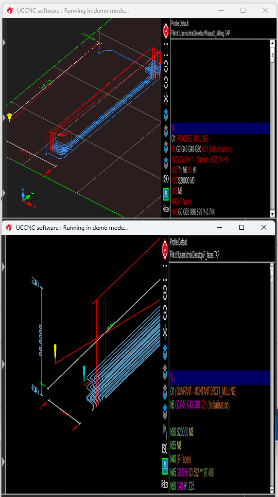

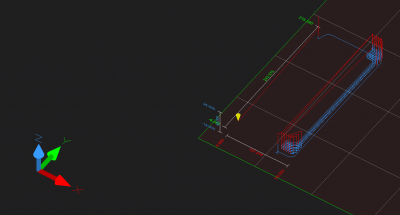

When a speak about wrong frame buffer settings, the look of the view is really depending on the zoom level : the view seems "scaled" instead of redrawn with a new size.
For exemple in "windowed mode", the previous version kept a correct aspect ratio whatever the size of the window. In this latest release, the view is stretched
v1.2115 on top

Yes, I confirm the aspect ratio issue when in Windowed mode and the window is resized, will try to fix this in the next release.

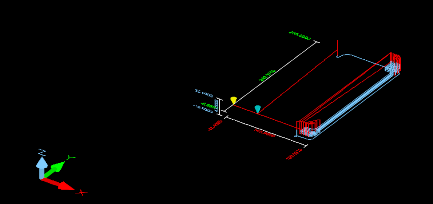

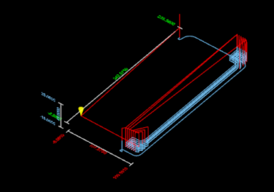

The stretching issue could cause my blurry effect : I'm using an ultra-wide screen (3840x1600) And I suspect the stretch is the cause.
I can clearly see "magnified pixels" instead having lines with anti-aliasing effect
I've also checked on another computer (windows 10 Intel UHD Graphics 630)
Here are 2 screenshots : the first is taken when the application in on the laptop screen (1920x1080) and the second, when I connect the laptop on my ultrawide screen
FHD
ultrawide
So, I got similar effect
