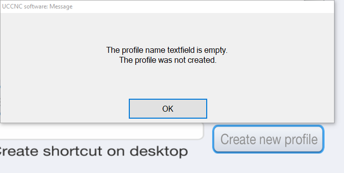

Anyone else unable to create a new profile beyond the installed Default and Plasma? No matter how many times I type something in there it will not create a new profile.

You have to press the ENTER keyboard key after putting in the text into the profile name DRO.
You have to do this with all DROs in the UCCNC software, this is a safety function which if you don't like then you can turn it off on the appearance settings page.
