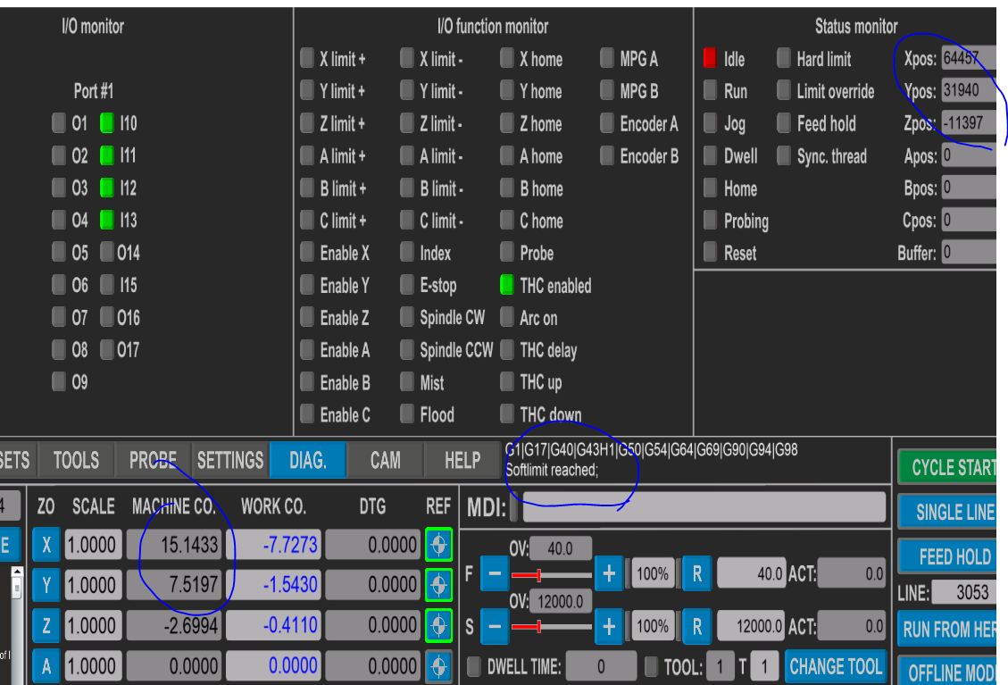

Postby Delco » Thu Apr 07, 2022 10:56 pm
Do you get a screen up saying soft limits exceeded ?

Postby jwhelget » Fri Apr 08, 2022 10:40 am
The attached screenshoot shows where it states soft limit reached.

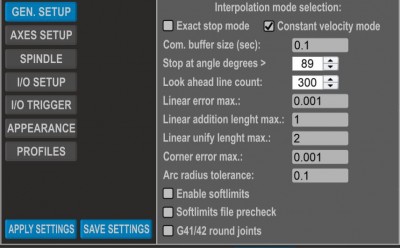

So softlimits is NOT checked here?
Re: soft limit randomly occuring, soft limits are not on
Postby cncdrive » Fri Apr 08, 2022 1:19 pm
Softlimit is as it name tells you is "software limits" is it programmed coordinates for the axes, it defines the boundaries in which the axis is allow to move.
Softlimits work only if the Enable softlimits checkbox is checked in the configuration.
Then the controller continously comparing the coordinates of the axis to the softlimits boundaries and if the axis tries to move out of that boundary then the controller stops the motion with a softlimits error.
If you not using softlimits then make sure it is disabled in the configuration at the place what Ger21 showed you.
If you using the softlimits then make sure to set the softlimits coordinates properly for your needs and also make sure to home the machine, otherwise the softlimits will not work properly because without homing your machine coordinates might not be referenced properly.
