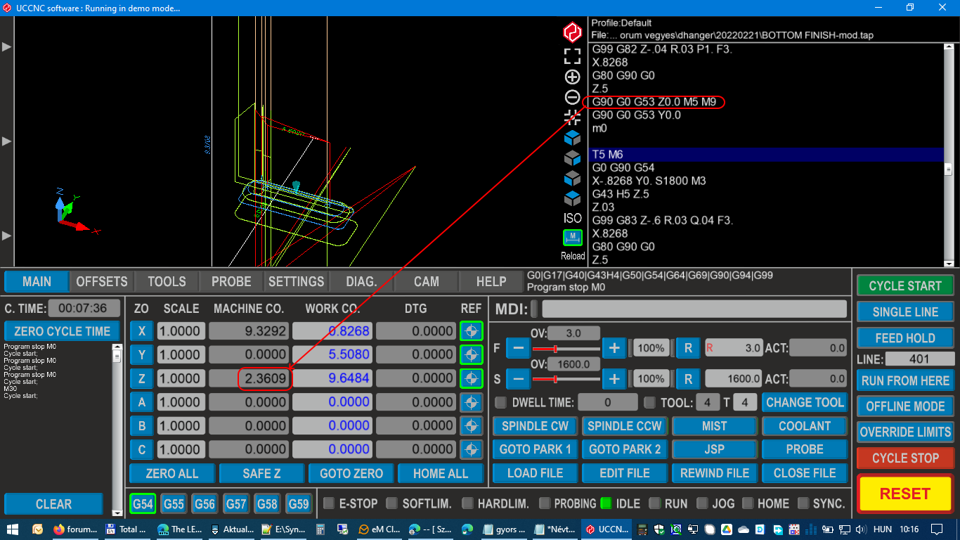

Postby dezsoe » Mon Feb 21, 2022 9:54 am
The problem exists:
Re: possible bug-drill cycle and cutter comp in the same pro
Postby cncdrive » Mon Feb 21, 2022 10:09 pm
OK, the bug was found and fixed, now in testing...
The issue was that there were cutter radius compensation in the g-code and the G43H.. did not apply the tool height in time, because there is a lookahead for the cutter compensation and then the G53 movement caused the issue, because it still read the old tool height. The issue did not exist with any other codes then the G53 and the bug was fixed now.
Postby cncdrive » Mon Feb 21, 2022 11:58 pm
No, not the cutter comp and drilling cycle is fine.
The G53 movement in machine coords is the issue together with the cutter comp, but only when a G43 H.. tool length offset is changed prior to the G53, so it is kind of a special case. Probably this is why nobody else encountered it yet, you were the first however this bug was always there. :)
