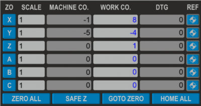

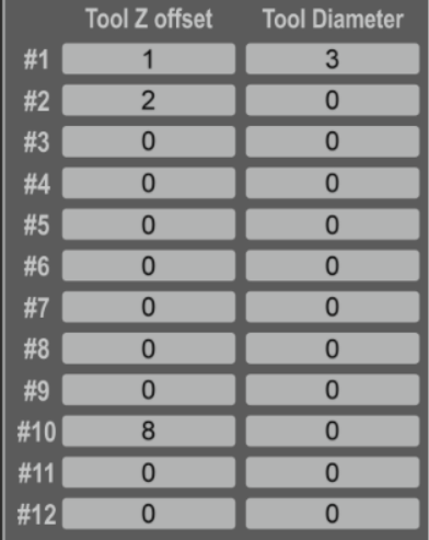

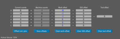

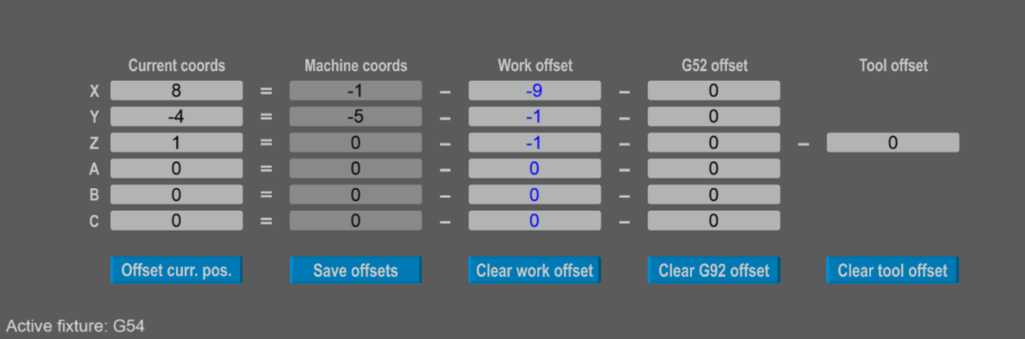

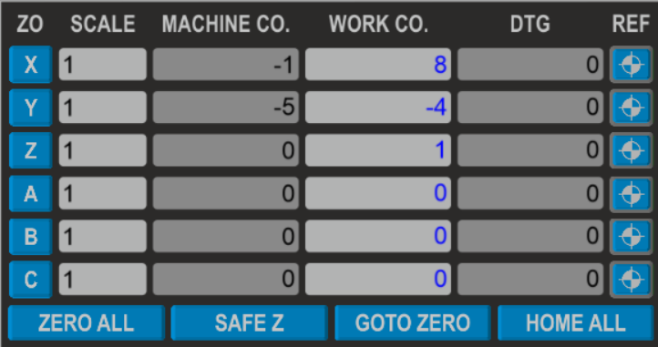

This is a weird one. See attached screenshots. I have no idea how this happened. It was fine for a while on this machine (a few weeks running fine) and then suddenly while I was trying to set up a new probe, all the numbers changed to integers instead of floats. I can't get it to go back to normal. Running in demo mode (not connected to the machine) does not change anything. Switching to the older screenset also does not have any effect. Anybody have any ideas? I've attached the profile, though I'm not sure that's the issue.

There's a general setting for number of digits in Position DRO's. Your's is probably set to 0.

Welp. I feel dumb. I thought I looked everywhere. Thanks for the help, I really appreciate the response.
