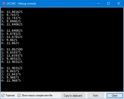

I modified your macro to show the Z machine coords at the beginning and after each movement. (Also commented out the G55..G59 resets, only to save my offsets.)

I got the following results in the console window after running the macro 4 times:
As you can see, all the movements were perfect. Does it work as you described when you start UCCNC or do you run any g-code before the probe? Maybe, the g-code changes something?
