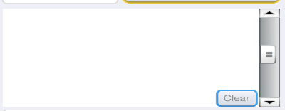

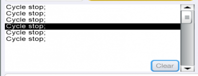

Hello,
i hope Balazs will anser this post. Like i wrote, if one of list oblect messages is selected, the selected line becomes black (picture1), but after that when you press the Clear button the black line remains (picture2). There is another thing. When you have messages in the list object and scroll down (picture3) and then click the Clear button, that will clear the messages but doesn't initialize the list object on the first line (picture4) and IMHO you can lost messages if you don't pay attention to scroll up the control manually. Thank you.
kig23
Posts: 161
Joined: Sat Mar 31, 2018 6:58 am
Location: Italy
Re: v.1.2105 - List object issue.
Postby cncdrive » Sun Aug 05, 2018 2:37 am
You can't loose messages, better to say that you can miss to see messages. I mean messages will not be lost just the Clear button does not scroll up and does not remove the selection mark.
I will fix this for the next release.
