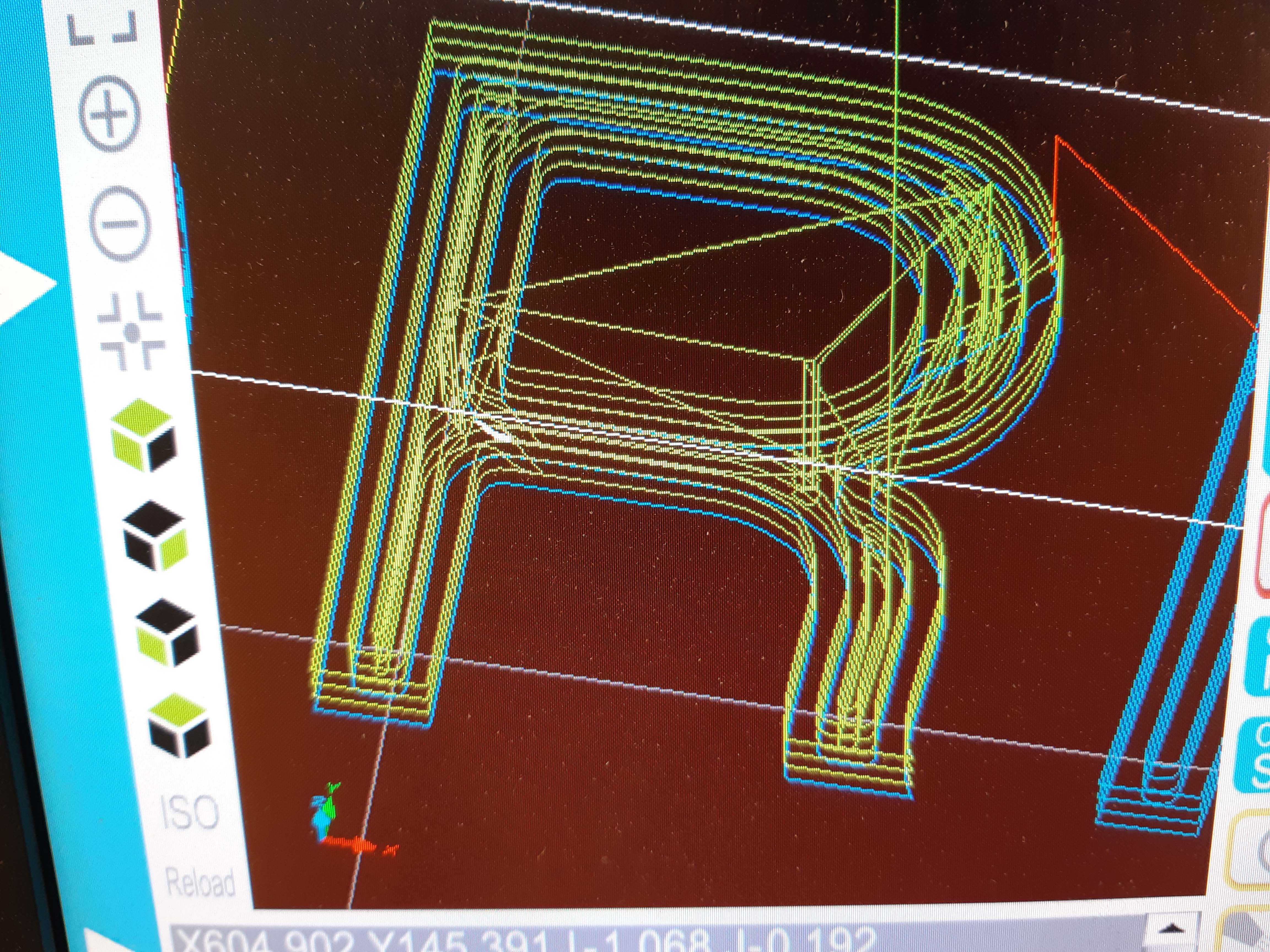

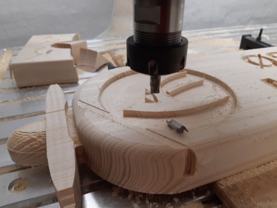

I have problem that it make bad move. Cost me the material and the bit!
Version 1.2104
HW:UC300ETH
And there is no explain, look good in Gcode, on Fusion and on the screen in UCCNC. And when repeat the program there is no problem.
It is not run on its limit of the speed.

Yes, the test version 1.2104 has a buffer problem when it randomly skips code. I recommend not to use it for production, only for testing.
This is always true for all test versions, that they are only for testing and that they might contain bugs until and if they go to official release.
