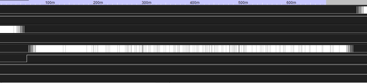

We've managed to measure your g-code step/dir signals out using a logic analyser.
Because on your photo it can be clearly seen that there is a movement to the cross (X) direction at the end of the cut we've eximaned the X-axis signals,
especially if any X axis movement happens between the Z pluge in start and plunge out finish.
The test results clearly shows that there is no movement at all on the X-axis between these.
So, my conclusion is that the issue is not with the UCCNC. I guess that the problem is that the cut is really deep (18mm) made from about a single pass.
What I think is happening is that when the cut ends it is at a so deep level that it cannot drop the wood chips out quick enough, so when the tool starts plunging out it probably vibrates the tool or even the axis when the servos try to compensate creating that deformation on the toolpath.
In the following I will copy the measurement printscreens.
I will do that in a few separate posts, because there is a picture number limit per post.
But first I'm posting the g-code which we cut down to see only the code of interest.

The following image shows the full g-code run with the X step, X dir, Y step, Y dir, Z step, Z dir signals in order from the top to bottom:
