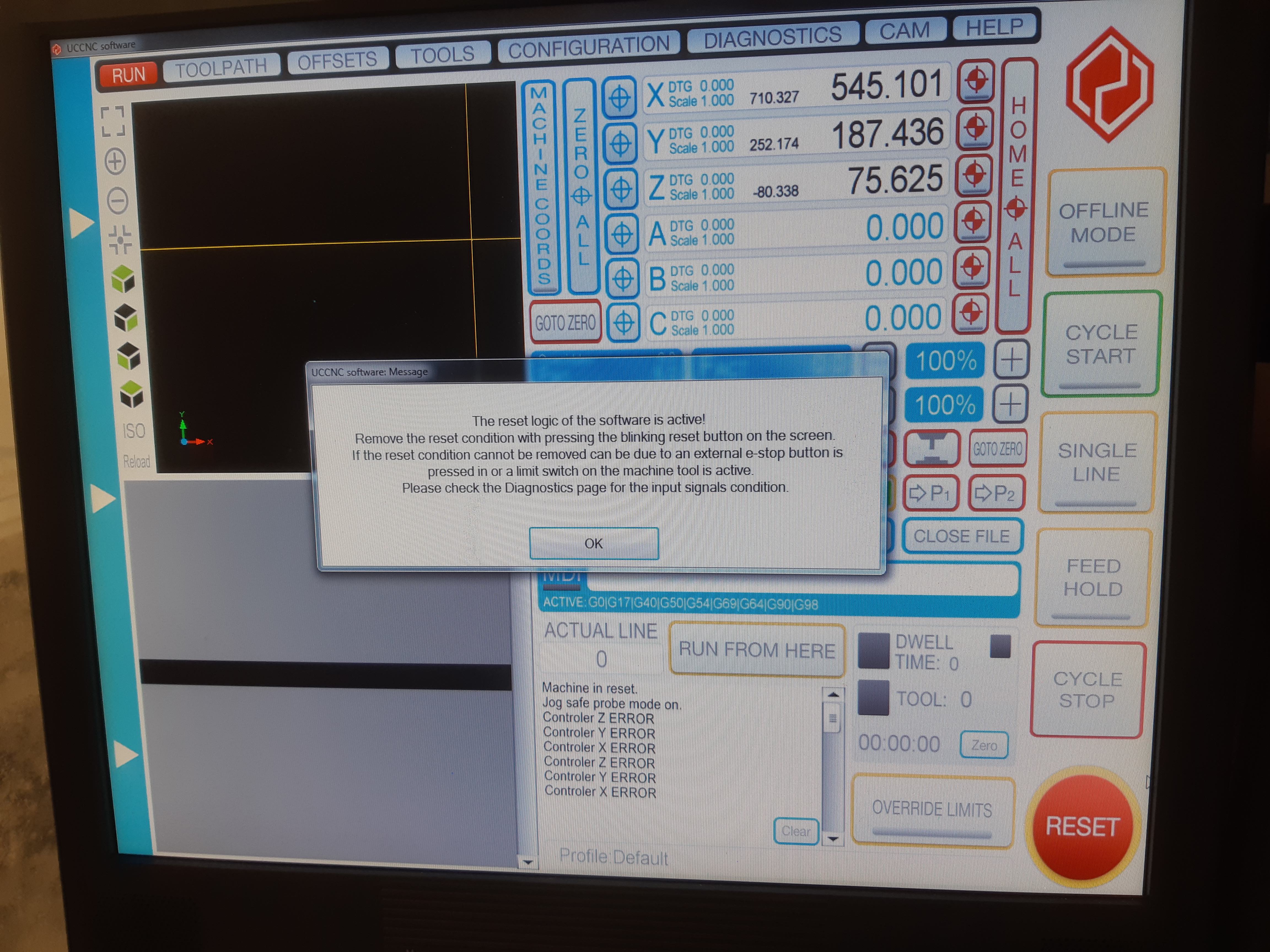

Postby kim@moltved.dk » Sun Mar 04, 2018 8:28 am
The machine was left in renset, and the screen look like this when i came back. Is it the remote that send random key to the machine?

Postby cncdrive » Mon Mar 05, 2018 11:38 am
Unfortunately we could not reproduce this issue.
We did the same what you did, left the software running the pendant plugin and have checked every few hours, but it did not reset the machine nor sent any commands.
So, we do not see why it is happening at you.
Because you suffering from this issue a relatively long time and I do not see a chance to reproduce the problem here or it could be even a faulty pendant device,
what I can offer you is to contact us in email and then we will give you a RMA number so you can return the product for a refund.
