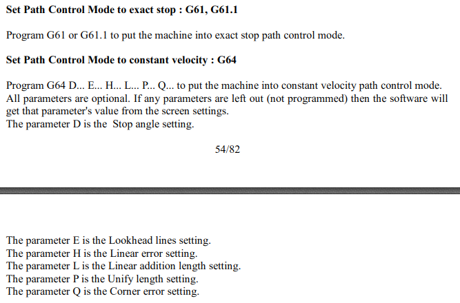

G61 & G61.1
Any chance of expanding on the current explanation of what the difference is?
Is it the same as linuxCNC?
