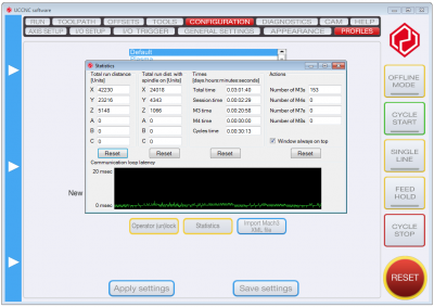

We've seen this a few times and it was always a network problem.
The issue is that the controller requires for the network to reply within 20msec in order for the system to work properly.
This is not a problem though because a network should respond within 1msec according to Microsoft, so it is well within what the UCCNC requires.
The issue happens if there something is setup incorrectly, for example if the network card is not working correctly, e.g. it's drivers has a problem, or if the network router delays or mixing up messages.
Could you please check the communication loop latency graph in the Configuration/Profiles/Statistics window.
The latency normally should never run to the maximum (20msec), otherwise there will be problems and it is an indication that something is wrong with the network.
I'm attaching an image about how a normal statistics graph looks like.
You can also test if the same issue happens or not with direct connection narrowing down the problem to the network card or the router.

I see in statistic window, latency is around 1ms when I Jog manualy or do nothing, but on every G command it goes above 20ms for some period.
I'll try to find and install separate network card for the controller.

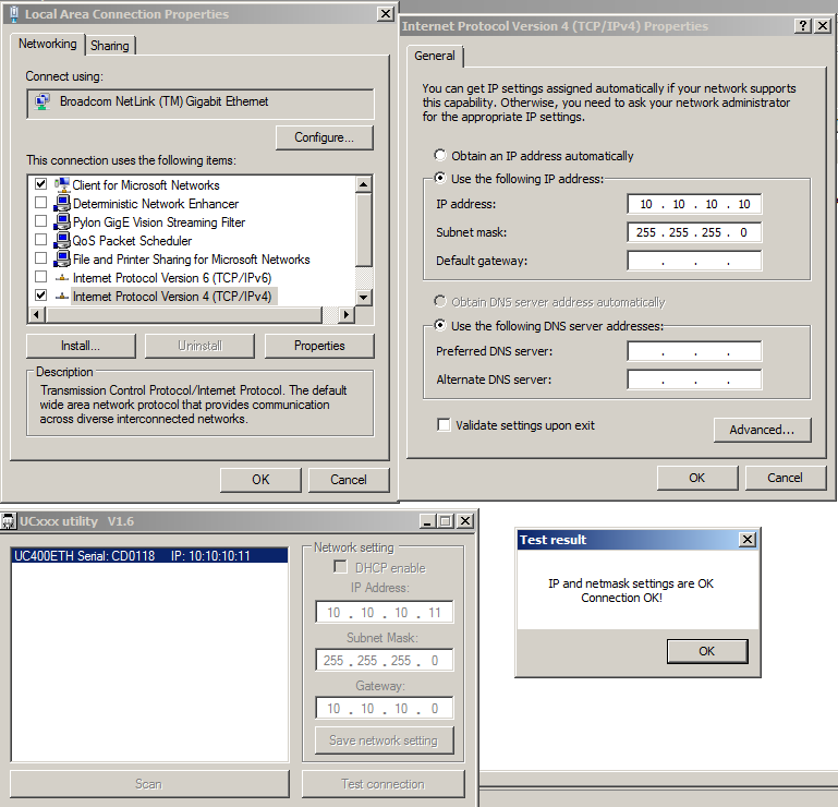

Postby Ivan Ionov » Fri Sep 08, 2017 11:03 am
Hello,
I tried direct connection with cross cable on another computer. Here is a screen with my network settings.
Here is a result video with latest official 1.2037 version -
profile is default, without any changes
https://youtu.be/U2HhMUe6KV8
from x100 position I enter -
G1 X0 F200
3 seconds pause with large network traffic then 2 seconds motion
I try higher feedrate -
from X0
G1 X100 F1000
1 second pause and no movement at all
I retry with lower feedrate -
G1 X100 F500
3 seconds pause then 3 seconds motion
I try very low feedrate -
from x100
G1 X0 F50
extra long pause (35seconds), 4MB transfered over network, no movement at all
jog movements with keyboard are fine without any delay

Postby cncdrive » Fri Sep 08, 2017 12:45 pm
OK, I see. Then the issue will be with the network card or with it's driver, because it is clear that it responds over 20msec which is not OK for the UCCNC, it can't work with this condition.
