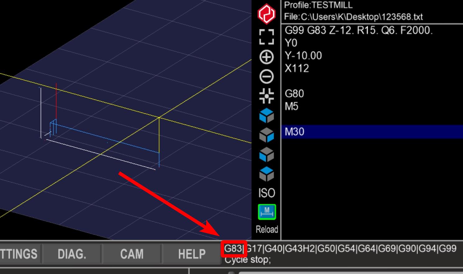

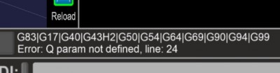

The program ends, but the canned cycle is not canceled after G80. The following MDI commands result in an error - "Error: Q param not defined"
Yes, I know that you can enter G0X99Y99 and then G0 will enabled, and the movement will work - But in the UССNС manual it says that
"G80. The command cancels the drilling cycle and the last programmed G0, G1, G2 or G3 modal motion mode gets enabled."
- This is not happening, please check it.
I tested this on version 1.2115.
I also noticed - if after G80 you add movements, for example
G80
X1Y1
X2Y2
- it works, the machine moves correctly, but in the status line G0 gets enabled only on the second line after G80
